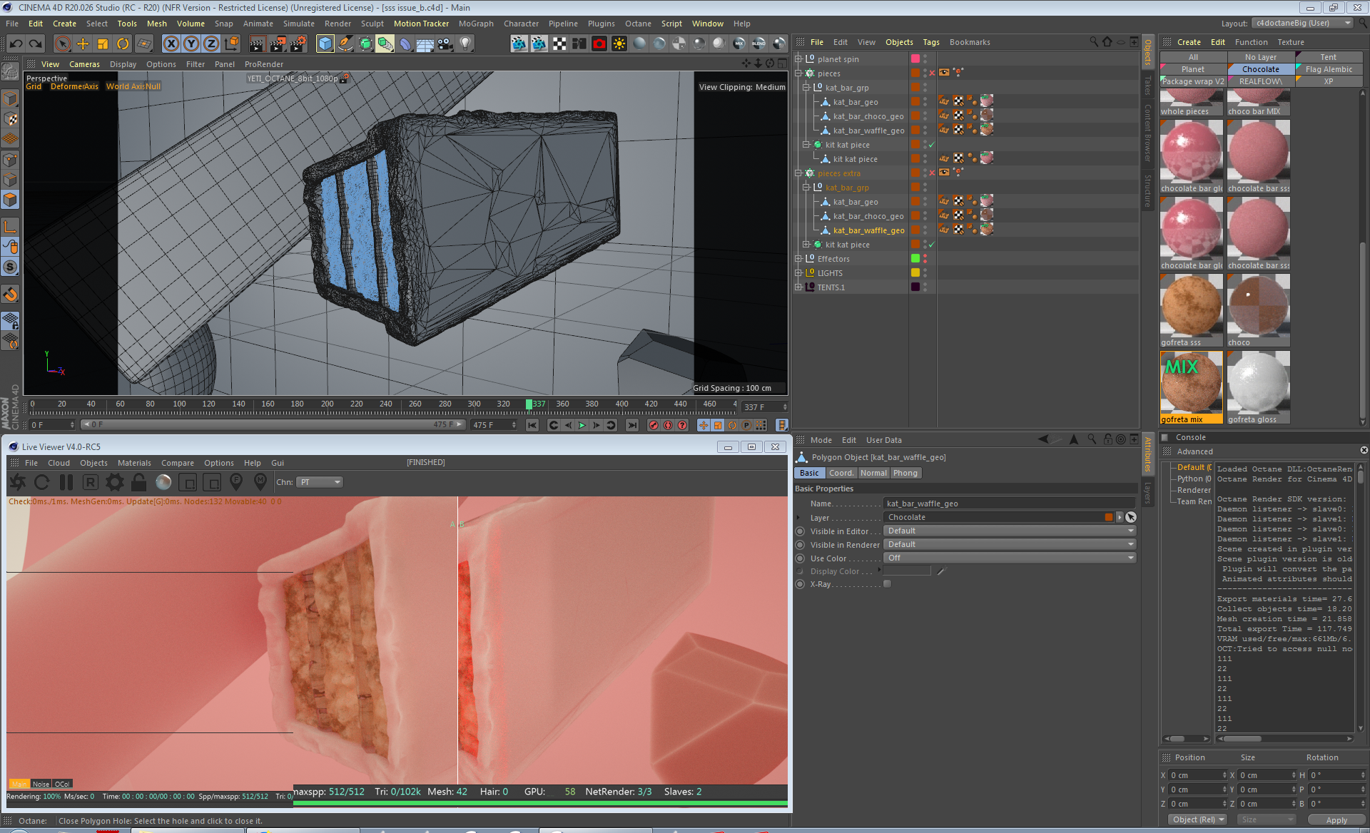

Hi, i have this SSS issue which i ve seen in other scenes as well in the past but never mentioned it. See image below these red bright dots/artifacts. What might that be? Geometry is not intersecting but even if did it shouldnt be like this. Do u need a scene for that? ty
Re: Version 3.08.4 (latest stable)
Posted: Tue Oct 09, 2018 1:35 pm
by aoktar
thanulee wrote:Hi, i have this SSS issue which i ve seen in other scenes as well in the past but never mentioned it. See image below these red bright dots/artifacts. What might that be? Geometry is not intersecting but even if did it shouldnt be like this. Do u need a scene for that? ty
It's not a plugin issue so send me an ORBX file if you can do or C4D file.
Posted: Tue Oct 09, 2018 1:44 pm
by thanulee
I dont think u need the textures for it but if u need anything else let me know, i stripped scene down
https://www.dropbox.com/s/pwom6hmqjlxzm ... e.c4d?dl=0

Hi thanulee,
I had a look at your scene.
The issue comes from how the specular meshes are modelled, since all the three meshes are opened, the light come out and create the unwanted effects.
Here is what happen if you close all the surfaces:
sss issue_b.7z
(1.13 MiB) Downloaded 384 times
ciao Beppe
Posted: Wed Oct 10, 2018 4:45 pm
by thanulee
Thanks alot! So i have to have always closed meshes and even if they intersect is all good?
