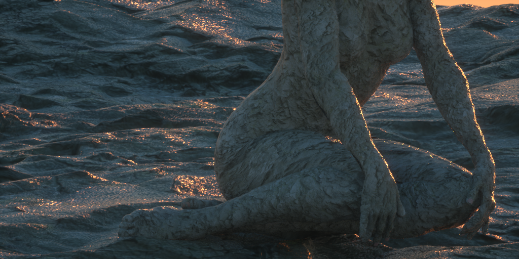

by bepeg4d
wow, great texture!!!
Here are some tests with the ROCK-02 set, no mix material used, all the textures are plugged directly:
no bump, normal or displacement
bump only
bump only
normal 1 only
normal 1 only
normal 2 only
normal 2 only
displacement only
displacement only
bump + displacement
bump + displacement
normal 1 + displacement
normal 2 + displacement

Posted: Wed Nov 18, 2015 6:59 pm
by Subroutine49690
just to make it clear. The free testmaps are as the name says only testmaps. The final is totally overworked and it doesn't have the same map-setup.
But the same surface in final status will be available in 4k for free as soon as the homepage is on.
The NORMAL is a alternative to the displacement if you have to save resources. If you don't see the silhouette it works perfectly. It has the same information like the depth-map !!
Only thing you can do to lower the displacment-depth is mixing the normal to have displ and normal together to 100%. That means for example 50% dipls and 50% normal.
Otherwise you get totally wrong shading

Rock-02
This is how it looks now.
Honestly, there is always development, so the earlier maps doesn't have the exact same level as the actual ones.
I think it's in our interest to rise the quality whenever it is possible - I do my best ;)
The point with the rock-02 is - it works best in up-direction used as rock-wall.
