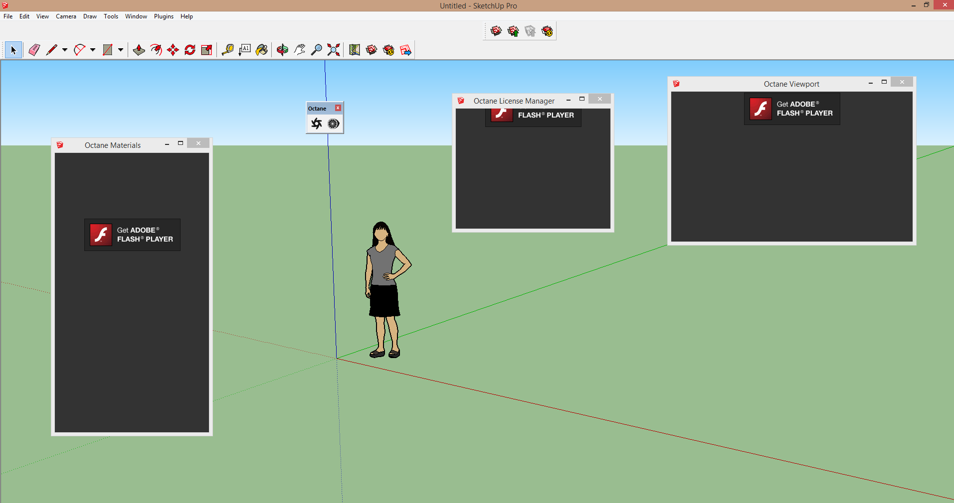

				Bro,
1. Hidden geometry is not working - this is extremely important. I need to have it im my models but I don't want them to be displayed. See the screenshot. Please fix it ASAP.
2. When I select the region render it is rendering in the selected region this is fine.
When I deselect the region render Octane is not rendering and I need to close it and open again.

				by Seekerfinder
				smicha wrote:Bro,
Make the face a group.  Then hide it.  Not sure if Fuzzy has hidden primitives on the road map (?) but this works well for most cases.

				by smicha
				Seekerfinder wrote:smicha wrote:Bro,
Seeker
Thank you for the tip - works fine but this should be definitely fixed. I have tons of hidden geometry and making a group each time will be a nightmare.
