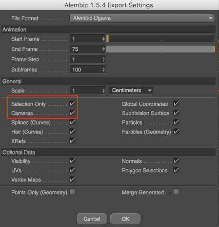

If I export a scene to an .ocs or .orbx, the camera node is gone (see screenshots). Do I something wrong?
I am on OS X, R17, Standalone 3.03.2b and Plugin 0.03.2-R4.

Hi David_S,
you can select multiple camera in c4d and export them in alembic separately from c4d export menu with this settings:
then, you have to change the scale from meters to centimeters within Standalone by clicking on the Edit setting button of the imported alembic node:
ciao beppe

by David_S
Ciao Beppe, that seems to work. Thanks.
