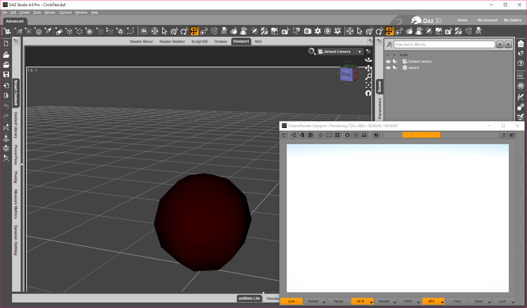

Attached is the zip file containing the 2 scenes files that I can sue to recreate the issue. Steps to recreate :
1. Open Daz Studio and load the cubeinstancestest.duf.
2. Open the Octane Viewport (This is important). All looks okay (Ignore the instances not showing up - Haven't yet updated to the experimental plugin yet)

3. Once it is loaded click File->Open and open the CircleTest.duf. You can say 'No' to save changes for the cubeinstancestest.duf.
4. Immediately you should see the error in the Systems Tab and the Octane Viewport will have the running orange bar.

Interestingly this only happens if the Octane Viewport is open when the File->Open / Open Reset is used to open a new scene. If I close the Octane Viewport before opening the new scene file, the error does not appear and then if I open the Octane Viewport it will open properly and render. So looks like when switching between scenes while the Octane Viewport is open causes some kind of initialization error in the plugin.
