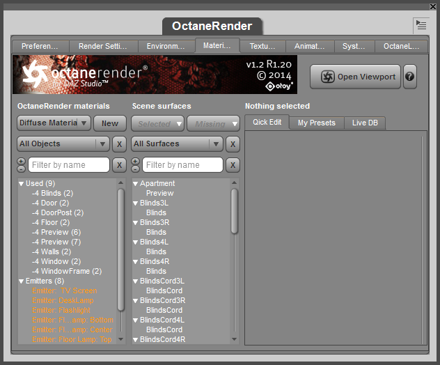

				The "Automatic material updates after content loads" option is adding negative numbers next to the each related material with every change.
So far this feature strips Octane materials upon related surface changes in DS.
				Re: OcDS 1.2.120.341x - BUG REPORTS
				Posted: Tue Feb 18, 2014 8:23 pm
				by t_3
				vortex3d wrote:The "Automatic material updates after content loads" option is adding negative numbers next to the each related material with every change.
should be both fixed now (the latter was somehow connected with the multiplying mat issue).
