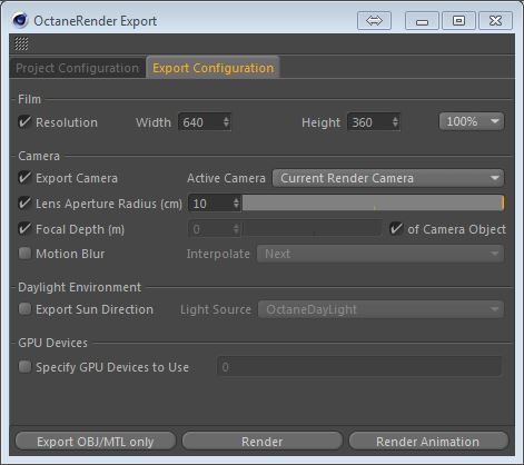

I have just tried with the exporter and Octane 1.55 and everithing works as expected. In my opinion, you don't need to export the camera in Alembic, please have a look at the scene attached and at this screenshots about the proper settings:

you have to animate with keyframes the Focus Distance in the c4d camera. If you want to use an object to control the focus, you need to switch to the integrated plugin.
