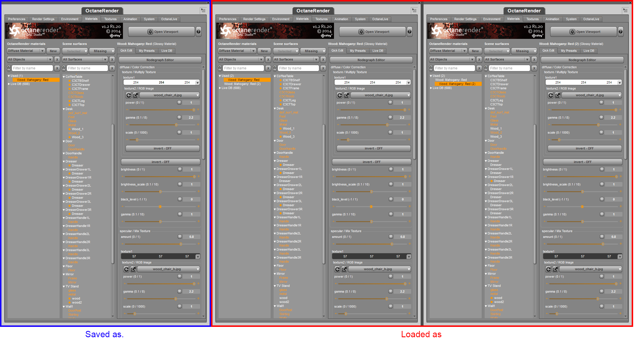

Re: OcDS 1.2.120.341x - BUG REPORTS
Posted: Tue Feb 18, 2014 2:55 pm
by vortex3d
Attack of the clones!
Shared materials split randomly on load and saving at this point will make matters worse.
I don't know what triggers this behavior, but I can't duplicate it with single items or basic scenes.
FYI: This test scene was stripped of previous Octane data using the plugin's function. Could that add to the problem?
Loaded immediately after saving and performing a CTRL-N to clear the scene.
Clear & reload of the same file.
