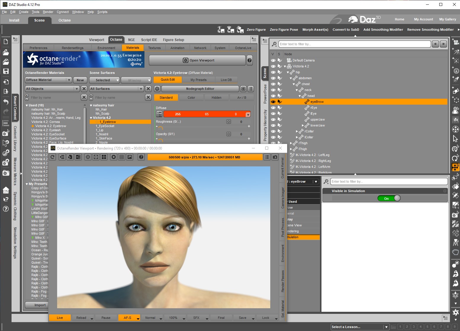

Ok, I downloaded V4.2 and made a render.
V4.2 base character render
Does this look to you ? There are no artifacts in the forehead. If this is okay, basically under Surfaces Material Filter remove everything and render. No need to set any opacity to 0 etc. Default Visible off works.

With the Surfaces Material Filter empty, lets say you enable the visibility of the 1_Eyebrow and lets say color is set to red. This is what I get :
1_Eyebrow visible, Opacity 1, Red Diffuse
Now if I set the Opacity to 0 in the material, there is no eyebrow mesh shown
1_Eyebrow visible, Opacity 0, Red Diffuse
So basically keep the Surfaces Material Filter empty:
Surface Material Filter should be empty
That way whether the 1_Eyebrow has visibility off in the scene tab / Visibility is on but Opacity is 0, it will not create the artifact in the forehead.
Hope this helps.
Regards,
Rajib
