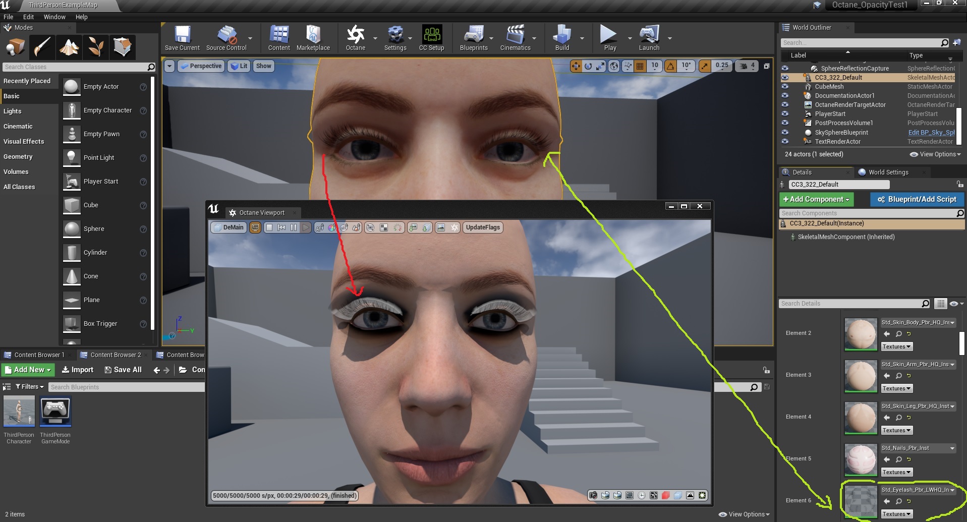

Hi Chris, I am going to send you link for a test project.
It looks like Octane .33 has issue with opacity textures on characters run through UE4.
(It has been the case since first release, but this project will be for 4.24.3).
