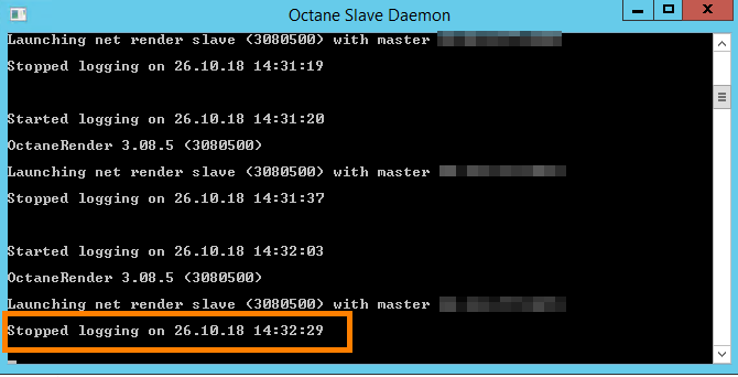

- For Batch render from render menu or Command line render. Open up the "OctaneRender network preferences" from the "Network rendering settings"
- And Untick or Disable the "Enable network rendering" option only no need to uncheck the Active daemons then close the dialog. This is because Octane render can have only one active connection with the daemon at one time. The slave daemon should look like this below:
- Now, open up a command prompt dialog then enter command eg; render -r octane YourfileName or click on the Render menu to do Batch Rendering.

Re: Octane Render® for Maya® 3.08.5 - 12.58 [ STABLE ]
Posted: Tue Oct 30, 2018 7:30 pm
by nedan
Thanks for the exhaustive answer.
It's weird that the network rendering runs well in Maya, but not in the batch. I have used with "-gpu1 0 -gpu2 1", and this was not working. I will try with yes/no soon.
Also, I did not Disable the "Enable network rendering" in Maya. Considering that Maya is closed during batch, this is necessary?
Thank you again.

Enable network rendering needs to be disabled if you want to do the batch.I had the same problem.

Hi Nedan,
Thank you. the GPUZ [ https://www.techpowerup.com/gpuz/ ] or the MSI afterburner [ https://www.msi.com/page/afterburner ] is quite useful to monitor the GPUs.
Try to include -agpu flag and set as NO or 0 when using the "-gpu1 0 -gpu2 1" flags. The -agpu flag as No will stop using the other GPUs in the workstation.
Could you please try to including the -agpu, -asl and -stdm boolean flags as true if the Maya is closed during the batch?
let us know how it go!!
Cheers
Posted: Wed Oct 31, 2018 4:40 am
by BK
Braca wrote:Enable network rendering needs to be disabled if you want to do the batch.I had the same problem.
Hi Braca,
Thank you!! Octane Slave daemon allows only one connection at one time so, we need to choose using it for IPR or Batch Render.
Disabling the "Enable network rendering" from network preferences will free the Slave daemon connection from Maya IPR render session.
cheers
Posted: Wed Oct 31, 2018 5:46 am
by nedan
.... Octane Slave daemon allows only one connection at one time so, we need to choose using it for IPR or Batch Render.
I understand that, but since Maya is closed... daemons are already free.... so why this needs to be disabled for batch? I am asking only because the reason looks like is not longer there.
Thank you all!
Posted: Thu Nov 01, 2018 4:32 am
by BK
nedan wrote:
Thank you all!
Hi Nedan,
Thanks for clarifying and yes you are right!! If Maya is closed for Batch rendering the slave daemon is free..
All we need to do is use the -asl and -stdm boolean flags as true. However, we recommend saving this two options "All available slaves for batch" and "Steal daemon" with the Maya file.
Cheers
