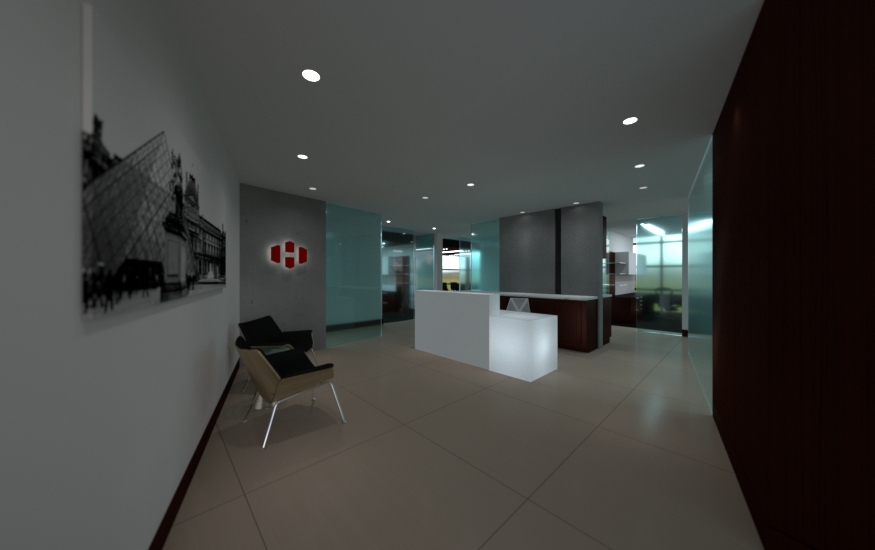

Anyone else notice darker renders coming out of 3.08.1.0? It's seems to be a gamma issue, but not quite. I haven't changed any of my RenderTarget settings either. I didn't use the 3.08.0 production build (went straight to 3.08.1.0) so don't know if it was an issue there. IPR works fine, but have noticed when I use the Save JPG/EXR feature, the images are darker when saved (same gamma issue?). Still on 2015.3, Octane 3.08.1.0.
Also, I don't have the new nodes that are supposed to be in there.
thanks,
bruce

Yes, it seems some kind of gamma or tonemapping issue. If you have all the LW color correction options disabled this should not happen. If you have a scene to reproduce this problem, I can take a look at it here.

That's what I've thought as well (Gamma/Tonemapping Issue). But I haven't done anything different, except load up the new version. Maybe it's related to how I updated, but I updated the same way as in the past and haven't had any issues. I'll try removing to the Master plugin this time and see how that goes.
Thanks for looking into it!
EDIT: UGH! Sneaky little bugger that LW. I was looking through the Color Settings in LW (like you suggested) and I must've loaded the Newtek default scene instead of the default scene that I regularly use and it had shifted all the color settings back to sRGB.
I apologize for time on something so simple, but I really appreciate that you've always been willing to help no matter what.
