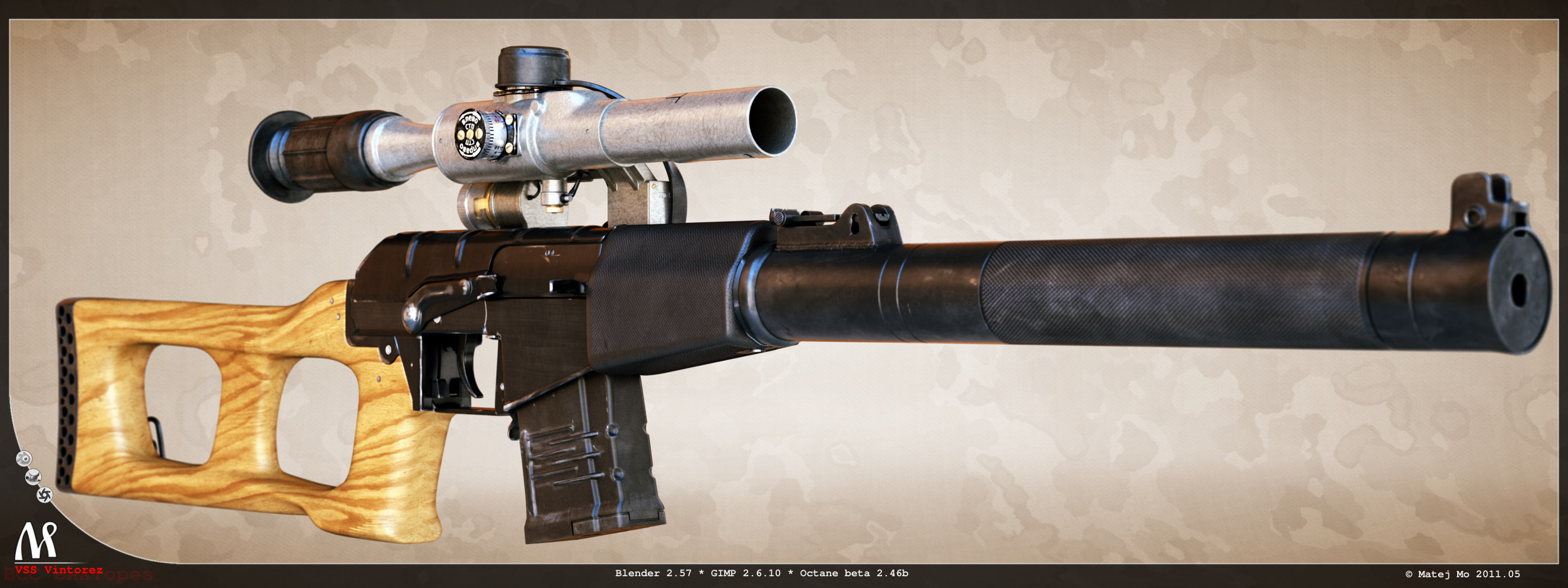

Here it is, the first final renders of this project. Path tracing ~10min, HDRI illumination, rendered with transparency and then composited with a background. Damn it was a lot of work, but the end result is probably worth it. I will do some real shots (non composited) in the future with this models, so stay tuned :)
Clay renders to better appreciate the model since I put a lot of effort into it. I like it how the pure clay mode still keeps bump & norm info.
The modeling is still not 100% accurate (just 90%) and I could still do tweaks to textures & materials. But somewhere I read that the CG artists work is never done - and this is soooo true! If you don't want to get stuck in an infinite loop of corrections & improvements of your render, then you must set a finishing line and try to be satisfied with the results.
Anyway, I need a break. :D Have fun.

Whoa! :shock:
That looks fantastic! I really need to start learning to texture like that! Modelling's always been my strong suit, but I've always found texturing to be a daunting and boring task.

by radiance
Awesome work :) This was my favorite rifle in STALKER: Shadow of Chernobyl :) Single head-shots :)

@Daniel, thanks. My preferred part of CG was always shading - creating materials & textures. Of course painting textures can sometimes be daunting, but so can be modeling :)

Can you detail your texturing process to us? The results are very impressive.
Also how many polys is the model?

by matej
The last scene is 962.475 tris in Octane. The texturing process is really nothing special; create the model, UV unwrap it, export the uv grid to GIMP, clean & prepare a base texture, paint your details (scratches, dust, etc..) according to the uv grid (I might do some texture painting in Blender, just to outline the regions where I'll draw the details later in GIMP), combine the custom paintings with the base texture into spec, bump or mix maps.
The process of creating materials in Octane is a little more involving. I go heavily with material macros & nodes, I try to reuse textures as much as possible, prefer to mix or multiply grayscale maps with color nodes over using RGB maps, etc... I also use the mix material a lot. The result of all this is that this scene fits into 520MB of RAM, so it's easily render-able on lower-end graphic cards.
The morale is: Learn to use Octane nodes because they are cool and at the same time you'll save yourself buying a 4GB Quadro :D
