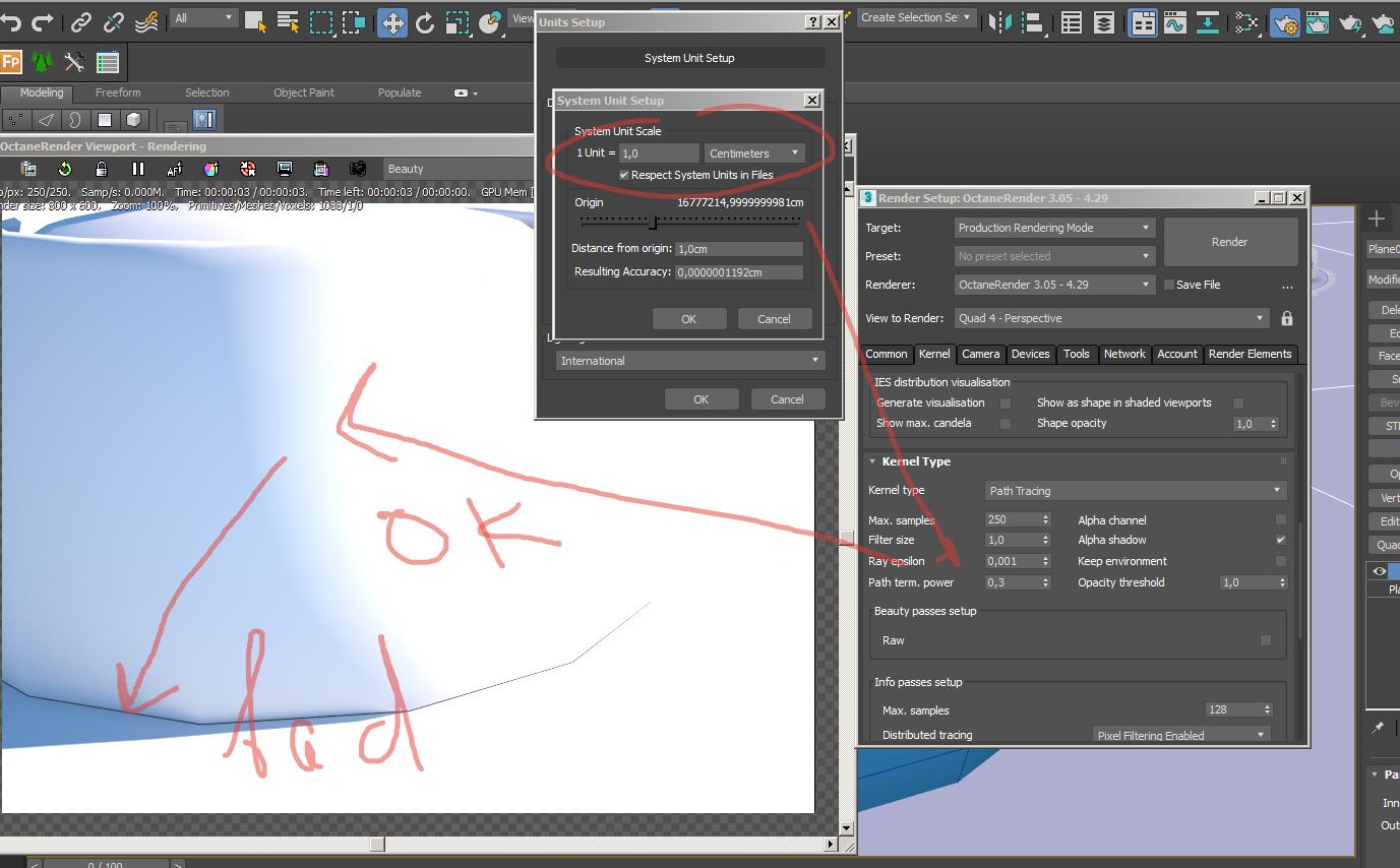

confirmed my initial theory, the problem is self-shadowing due to too coarse geometry or too small ray epsilon.
You have to either decrease the triangle size by subdividing the sphere higher or to increase the ray epsilon.

brilliant to change the ray Epsilon - well let's say ..... 1. I have CM ... for real work I need to do 0,00001 but what would appear the correct shade in low medli I need the ray Epsilon value of 0.001 . . . and what do you suggest I do
download/file.php?id=59437&mode=view
mode 0.001 shadow on the object behaves correctly but AO not working right
