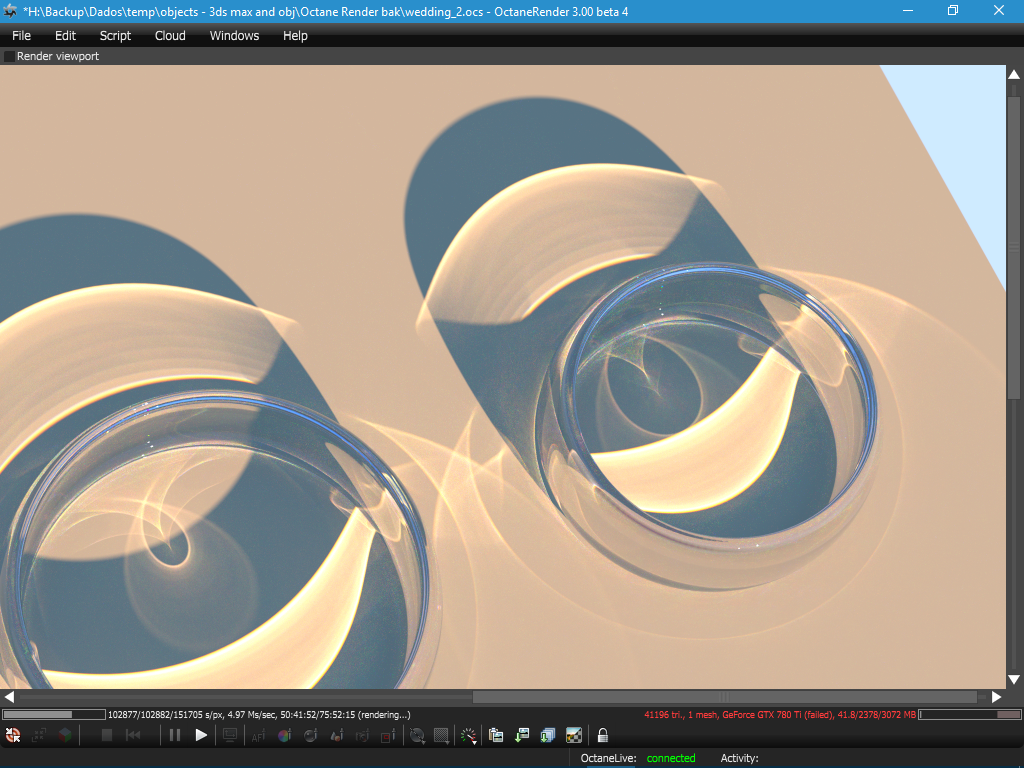

Think some causes of error... After 61 hours of my renderer in v2.25, I didn't want reboot PC, I had rendered v3.00... and got error 2 times (1st ~10 minutes and 2nd ~2 hours). Stock VRAM speed is issue.
I downclocked VRAM from 7000 MHz as stock to 6840 MHz.
2 days after reboot PC, I'm rendering 40 hours (81500 of 151708 S/px) using v3.00 beta4 - still no problems at 6840MHz VRAM... But at resolution screen of 3840x2400.
Full load - now 64 ÂșC at ~87% fan speed.
I'll end render at 01am UTC on monday.
I'll leave my GPU to RMA in end of this month, if I'll get still white flicker bars in GT2 - 3DMark11 at all stock speeds after display driver uninstaller (DDU)
