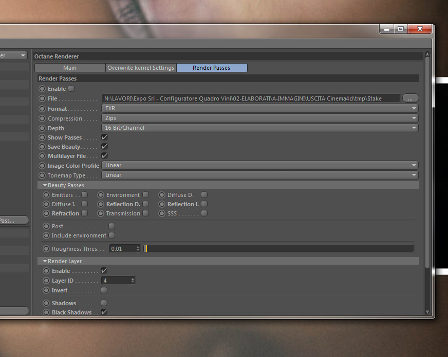

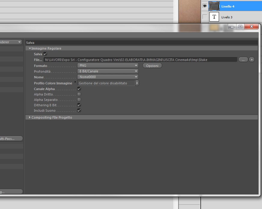

Ah, very easy to say:
http://c4d.cn/help/r17/US/html/54506.html
you have just to set in render settings as Save Tab file, some variables like:
$take: that read the name of the take list and put it as folder name or file name, etc.
$rs: Current Render Setting name
etc.
very useful if you have to generate a lot of images (like for a configurator f.example).
It seems to work from the Cinema4d Save file tab name, but not from Octane Renderer passes Tab

GIOLETS wrote:Hi I've made also my test and the Takes System seem to go very well with all the elements of the scene.
I've found also that token don't work, so I ask if is possible in the future to have this feature because would be really useful when you have a lot of name of files to give; with token the name could be read directly from the Take list.
+1 this. The Take system is super useful and works perfectly apart from the save tokens.

Thanks! Added to my list. I'll check for possibility. Problem is we use custom gui and functions for some file operations. I hope that's possible to inject.

Not yet. Try C4D's multi-pass saving route.

Not broken. It's not implemented. Use C4D's native image save sections if you need. I'll not add this functionality on passes in any short time. It's not easy or possible atm.

Correct me if I'm wrong, but isn't the only thing keeping the take system from working with octane, the lack of token support in the save path of the octane render settings? Everything else should be taken care of by C4D itself (Changing tags/visibility settings/render settings) and seamlessly translate over to octane without any changes from your side.
Implementing tokens would also be very helpful in other scenarios, for instance when you automatically want to name your output renderings to the name of your project file. I also noticed, that relative paths are not supported in the multipass output path of octane (Maybe I'm missing something : ) ).
This should be fairly easy to implement and would go a long way of making octane for C4D more production friendly. If you're unsure of what the token system does exactly I'd be happy to help out where I can.
