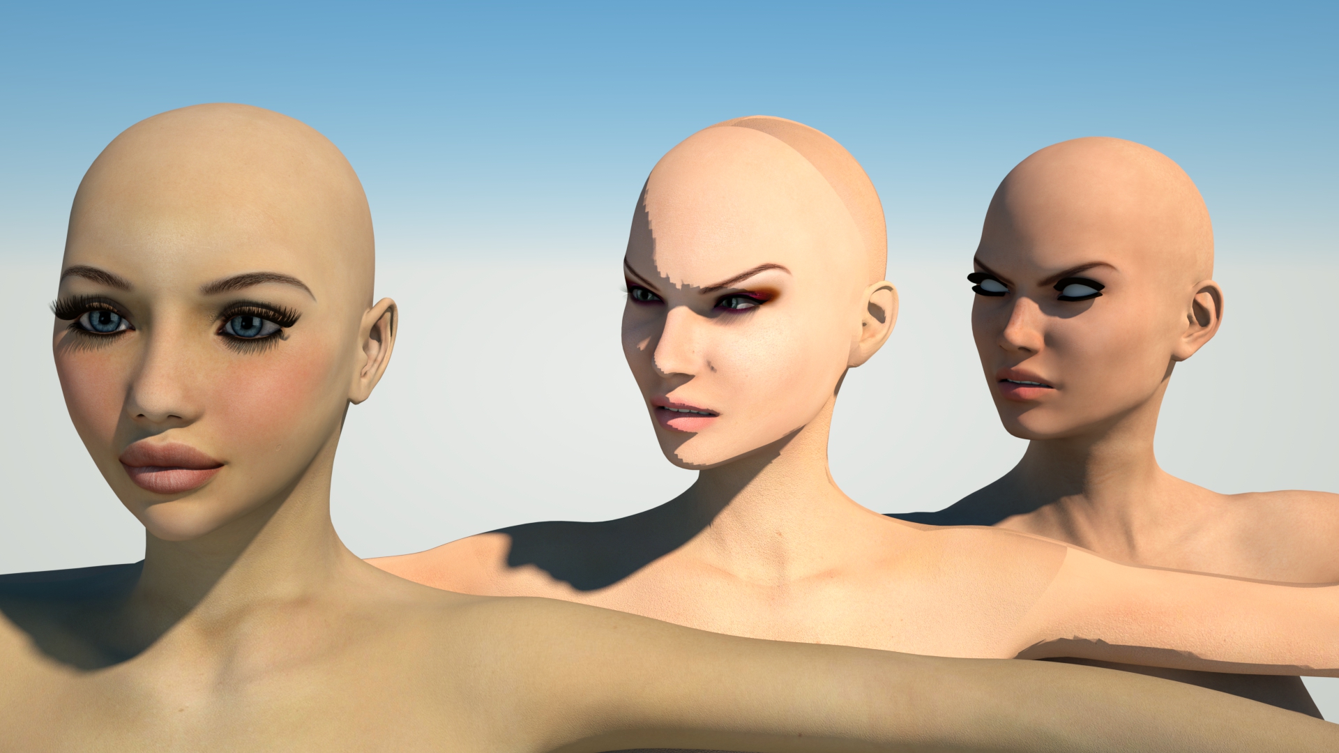

Posted: Wed Nov 25, 2015 5:45 am
by Notiusweb
Unread postby face_off ยป Wed Nov 25, 2015 4:12 am
As a result In the "last beta" build 2.23 a more complex material conversion was introduced.
Instead of creating a basic diffuse material as before now a Mix material was created.
If I add a Props->Architecture->Aikanaro->NoAi-ColumnWall, then Materials Tab->Missing->Create as auto-materials, the resulting materials do NOT have a material mix. So I am not understanding the issues posted above regarding this.
Paul
Maybe it was character dependent, in that newer iray-specialized characters are coming over differently?
In any event, try this...load a Genesis 1 and Genesis 3 character side by side. Add materials from some respective G1 and G3 character to them...
Genesis 1 comes through into OcDS with Glossy or Diffused materials, and renders properly.
Genesis 3, if SSS/3Delight mats, comes over with Mixed Materials.
Genesis 3, if Iray mats, comes over with Diffused, like we want, but has the opacity/mask issue I described in the earlier post.
I mean, it's starting to scare me...look how mad they look!
L to R - Genesis 1, Genesis 3 (SSS/3Delight), Genesis 3 (Iray)
Re: Materials Conversion - Current Issues and Requests
Posted: Wed Nov 25, 2015 2:35 pm
by Notiusweb
Just to add on the SSS mats-
it is not the Mixed Material header that creates the issue, and if you select Diffuse header from the drop down it does not then automatically 'fix'. What fixes it is turning off the Normals map node, or even more specifically, setting the Normals power from 2 to 0. So, it's almost like the offender is Normals node power at 2.
You know, the Normals power at 2 actually creates an interesting Toon Effect. :idea:
If it wasn't for the pixelated shadows, it would look really cool. I would say it could be a feature later to have a toon mode, where the Normals map goes to 2, if somehow it could have the shadows rounded/blurred...
I would call it something really wild and super-innovative, like "Toon Mode"....yeah...
