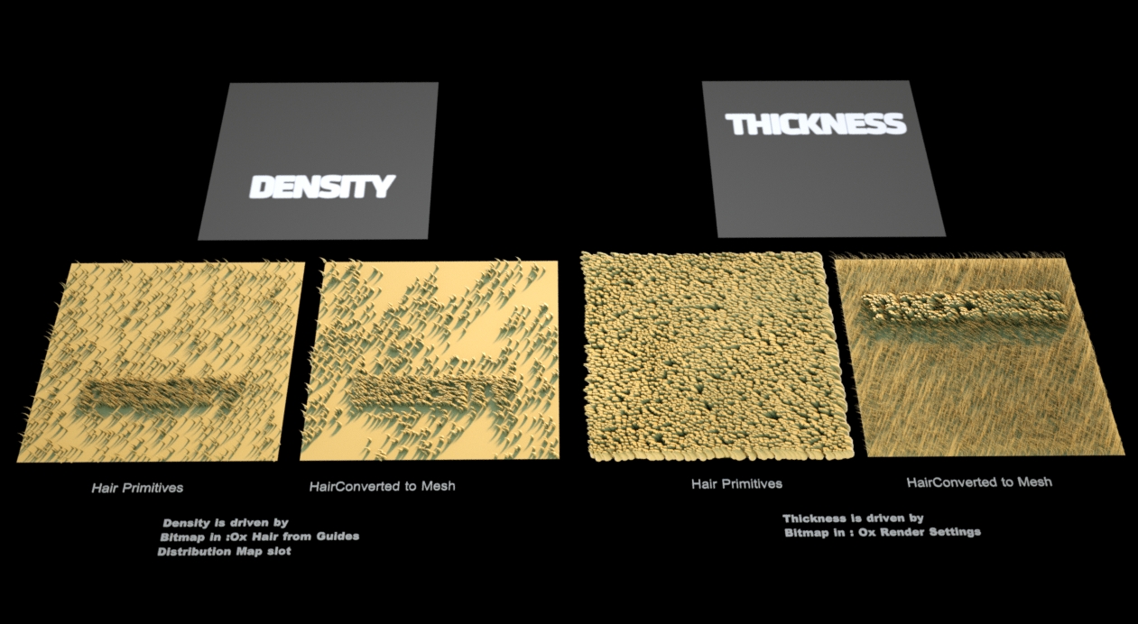

Bug
Hair with Ornatrix.
Hair thickness driven by a texture doesnt show up with Octane
The image on the right is hair converted to mesh.
Image on the left is with hair primitives.

Jim Hello,
You're right. So, I've prepared a scene regarding my issue.
The problem is Octane doesnot understand Ornatrix hair' Thickness parameter driven by a bitmap.
If you can have a look at the image below you'll understand the issue.
I also added the scene file for you to test it out.
The main problem is using hair primitives, not hair converted to mesh.
I cannot set the thickness by a bitmap.
Whereas it works if I use a similar bitmap to drive the density of the hair primitives.
I've contacted Ephere about the issue.
Marsel Khadiyev responded saying..
Sounds like the issue is coming from the Octane end and not Ornatrix. I have contacted their dev.
Marsel Khadiyev (Software Developer, EPHERE Inc
Here is the render describing the problem.

Re: OctaneRender® for 3ds max® v2.22.2 - 1.3 [TEST]
Posted: Sat Apr 25, 2015 11:36 am
by JimStar
oguzbir
Thank you! I will check it.
