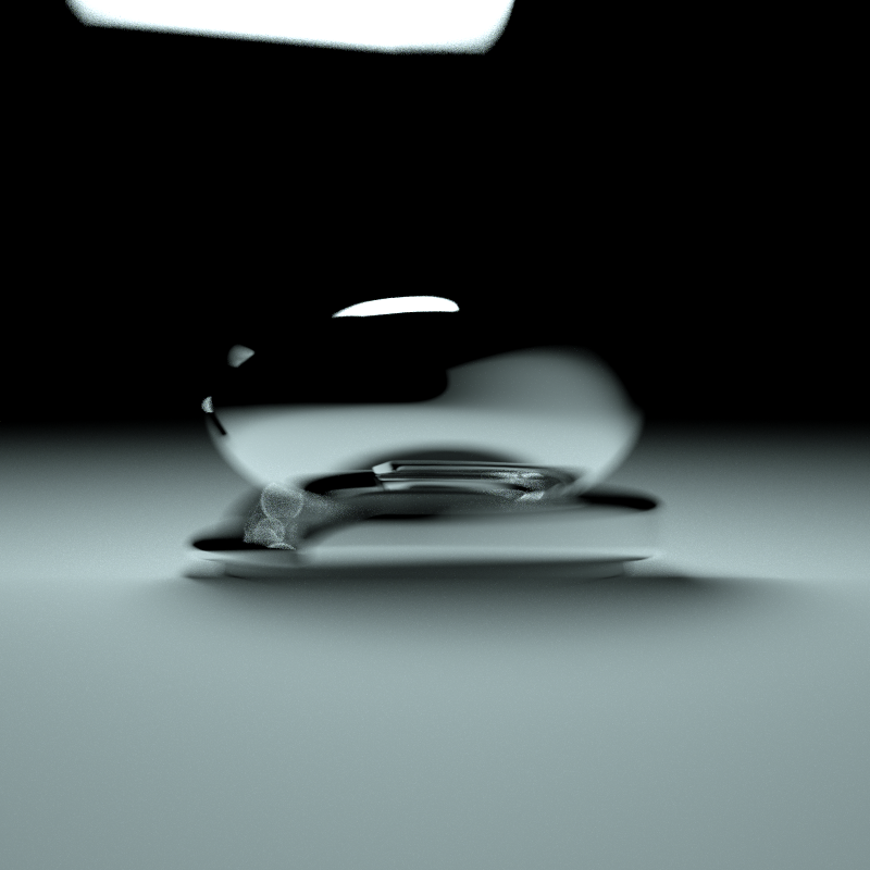

Ok, how about this:
I add two new inputs to the thinlens camera: One to control the pixel aspect ratio (to allow you to render non-square pixels like NTSC/PAL) and one to control the aspect of the DOF disc . This how it look like in action:
Pixel aspect 1:1 / DOF aspect 1:1:
Pixel aspect 2:1 / DOF aspect 1:1:
Pixel aspect 1:1 / DOF aspect 2:1:
Pixel aspect 2:1 / DOF aspect 2:1:
Pixel aspect 2:1 / DOF aspect 1:2:
Do you want to be able to set those ratios as fraction (i.e. two float values) or as a value (i.e. one float value)?

abstrax wrote:Pixel aspect 1:1 / DOF aspect 2:1:
That's getting there, and much quicker than I thought :D
Slight difference, though, with anamorphic in that the difference between a 1:1 and 2:1 is that the DOF disc in the 2:1 image is shown here as half the height of the 1:1 DOF disc, instead of twice as high with an anamorphic lens.
I would think that since both pixel and DOF aspect ratios are both n/1 by nature, a single value would be sufficient for each. So bokeh aspect ration would be "2".

riggles wrote: Slight difference, though, with anamorphic in that the difference between a 1:1 and 2:1 is that the DOF disc in the 2:1 image is shown here as half the height of the 1:1 DOF disc, instead of twice as high with an anamorphic lens.
So just invert the horizontal/vertical stretching behaviour - like this? (pixel aspect = 1, aperture aspect = 2)
Ok.

abstrax wrote:So just invert the horizontal/vertical stretching behaviour?
Yes.
There's a lot more physics going on in a real anamorphic lens, like it's unmistakable capturing of lens flares, and also it's change in effective focal length. But this is a very nice start in the right direction. Thanks for taking the time out to give this a whirl~
Yes.
Ok, done (will be in 2.22). Anything more fancy will have to wait unfortunately, but I created a ticket so it doesn't get lost.
