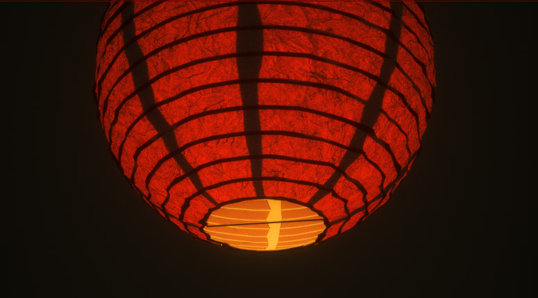

SUCCESS!
Tom, you were almost there with your test. You just needed to increase the brightness, and add an Octane object tag to the interior pieces and set the visibility down a little. Aw man, this is great! I'm going to have some fun with this lantern now that I've got the look down. Tomabobu, thank you so much for your help on this! It renders really fast too. Just need about 200 samples and its clean! I was able to get a single frame of this lantern rendered in about 20 seconds. Not bad!
I'm uploading the "final" project files for this lantern so others can download and experiment with it, as a thank you to this awesome forum! Thanks to everyone who helped out with this!
