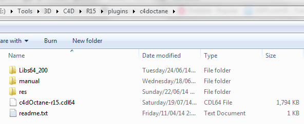

Standalone 2.03 is working well and R14 too
I attach my R15 folder screenshot maybe I missed something
Re: Cinema 4d R15 and Octane 2.02
Posted: Wed Jul 23, 2014 11:50 am
by aoktar
remove vcomp100.dll and try again. Send me a console window and octane log output, if it still don't works.

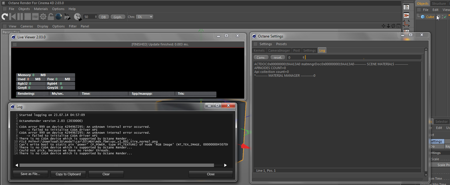

aoktar wrote:remove vcomp100.dll and try again. Send me a console window and octane log output, if it still don't works.
Still not working
R15
render log:
Started logging on 23.07.14 04:57:09
OctaneRender version 2.03 (2030000)
CUDA error 999 on device 4294967295: An unknown internal error occurred.
-> failed to initialise CUDA driver API
There is no CUDA device which is supported by Octane Render...
FILE PATH=F:\Download\3D\model\car\03\MDX\mdx.fbm\vpc_v1_002_tire_normal.png
Can't write bool to static pin 'power' (P_POWER, type PT_TEXTURE) of node 'RGB Image' (NT_TEX_IMAGE, 0000000045070FD0)
Could not pick, because we have no render threads.

It's saying no Cuda device with some error. I'm not sure how can you render in R14 and SA. What's your nvidia driver(3rd times i'm asking)?
Also suspecting for other plugins. Someone which has cuda dll's can cause conflict

ok i'm going to beginning. What are you seeing here?
IMPORTANT INSTALL NOTE:
This version requires Nvidia driver 335.xx or newer. Also matching version of Standalone 2.0 is highly recommended.
And remove all old plugin files before installing. Any version conflict or old drivers can cause crashes

Sorry aoktar, I missed this part. I'll update my driver now
so strange why R14 working well
