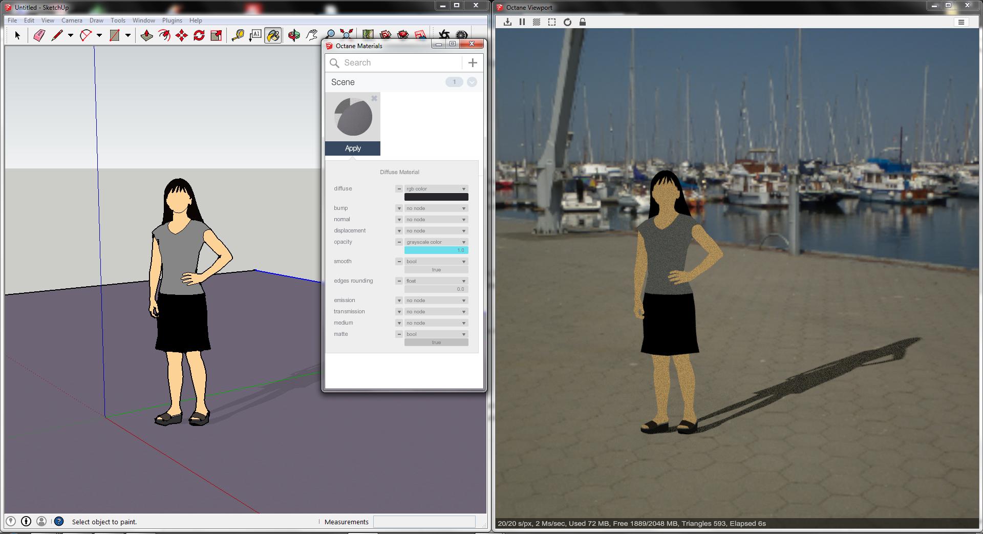

FEATURE REQUEST: Would it be possible to have a function where we hide geometry that catches a shadow while retaining the shadow?  Effective a shadow catcher in the plugin.  I see we don't have the MATTE setting in the diffuse material node in the plugin.  But having an approximation of shadows in SU without going to a 3rd party composting app would be the preferred workflow for me anyways.  This would be great if possible!
Hi Seeker!
Matte should be there (check attachment). Just make sure that geometry is facing the right side. When you create a plane in SU it is facing the wrong direction (bottom), so I had to reverse the face and apply matte material to get this picture.

				Seekerfinder wrote:Seekerfinder wrote:
BUG: Environment light source won't switch back to SU daylight after having added an HDRI / image - see image attached.
Another issue possibly linked to this?  When I assign an HDRI to the environment, that same image appeared when opening an older file!  Mysterious but true.
EDIT: Ok, this only happened once.  It may be when multiple files are opened simultaneously?  You might look into that one.
Best,
Seeker
hello mate, regarding the hdr texture environment, this happened in the earlier versions too, it only happens when we enable "Use Sun". For some reason the option "se Sun" locks the environment even if we go back to SU sun. Until Fuzzy kills this bug/feature we just need to uncheck "Use Sun" option.
About matte option it works here. Normals must be correctly faced.
EDIT: Just saw that Fuzzy already posted the answer
cheers
Oi.  How did I miss that.  Thanks Fuzzy.

				resmas wrote:hello mate, regarding the hdr texture environment, this happened in the earlier versions too, it only happens when we enable "Use Sun". For some reason the option "se Sun" locks the environment even if we go back to SU sun. Until Fuzzy kills this bug/feature we just need to uncheck "Use Sun" option.
Thanks Resmas!  That works.
resmas wrote:About matte option it works here. Normals must be correctly faced.
Wow.  Just discovering this feature...  I am so enjoying this plugin!
