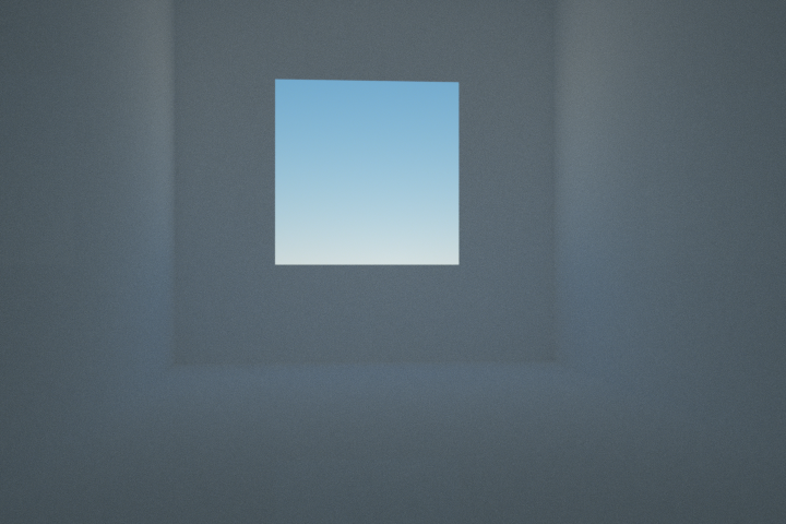

FOG interaction with Portal On - Off comparison

Re: FOG interaction with Portal On - Off comparison
Posted: Fri Mar 28, 2014 9:00 am
by sikotik13
Best guess from looking at images: you are confusing the hell out of the program with normal inversions stacked with normal inversions. Would explain the odd square with the portal off, the normals are still reversed of the reversed sphere. Portal on would probably just send it into spastic fits since there are now normals in every direction it's supposed to be tracing. I'd give up too, lol.
