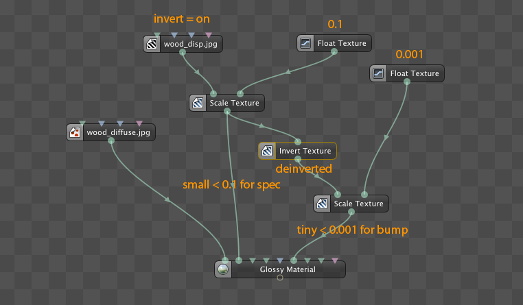

very nice, but i'd add some closeups and such and make it a little bit longer.
awesome work.
also, some experiments with the wood (diffuse, specular, bump would be cool).
when doing colseups, you really want the wood to look very very good, even painted wood should still have the same wood nerves/grain bump (+ extra bumps from the dried paint) on it)
for that train and track, try a glossy material with:
diffuse map wood_diffuse.jpg: wood_diffuse.jpg
specular map: 'scale' texture node: 'floatimage' texture wood_disp.jpg (enable 'negative' to negate it) and a 'floatexture' making it small, eg 0.1 giving it a low power
bump: same as above but with an additional scale to scale it down even more, and negate it back to non-negative again.
like this:
the 2 image textures are attached.
