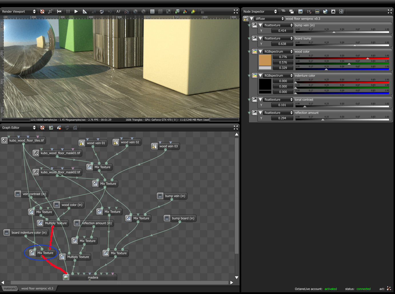

I'm having a little problem, I've thought of a way to add more randomness to the vein direction and have control over it, again since we don't have tile procedurals (I won't get tired of asking this, wink, wink wink) I did some extra maps for masking purpouses and added some transform pins to my vein texture. It works great, but the tree that controls the color channel doesn't work as expected. If I connect the multiply node that control wood color to the mix that gives control over the indentures color, the result is a white color. It shouldn't be. If I overpass that last mix all works. I looks good althou I've lost the chance to control the indenture. Any ideas? is there a maximun node stack value? if so If I did the mix in a macro texture would it help?
I haven't uploaded v0.3 till I figure this out.
this is how it looks minus indenture color in a more worn old board look just playing with presets
you can see in red the original link and the problematic node in blue

@kubo, maybe you need to invert the texture that controls the mix in the incriminating node? It's hard to tell just by looking at the picture of a node system (I get confused even by my own :D).

matej wrote:@kubo, maybe you need to invert the texture that controls the mix in the incriminating node? It's hard to tell just by looking at the picture of a node system (I get confused even by my own :D).
Yeap, me too. But no, the mix goes like this, a b&w image with the board tile is the mask the first mix color is an input pin that controls the color of the indenture (actually almost black) the second mix color is the wood color, which is the multiply that works fine, but when I connect it it just gives a white color. Before I added the extra randomness it worked fine, after that it stoped working, that's why I'm guessing there must be some stack limit.

kubo wrote:that's why I'm guessing there must be some stack limit.
You are right. On the seventh mix node, the texture goes white. You have 5 levels in the material + those in the texture macro. You'll need to reroute the system so that the tree structure is max 6 levels deep. Another thing to write down for a feature request.
EDIT: This limitation (bug?) affects all the mappings - invert, clamp.. not only mix & multiply.

thanks, now I'll try to work around that.
update:
Well thanks to Matej I've found a way to reroute the color tree and keep all variables as I wanted, indenture color is more subtle than before but I think that looks better.
Besides some minor tweak the main thing is that I've added the board randomness in a way. For now I'll wait till we have some more nodes like global scale control, and random tiles and float texture gets fiexed to get lower values so I can add control to roughness and such so I can convert it to fully procedural. I have to say that I'm pleased with the results, and even thou I might need to tweak it further it looks close to what I had in my head (which is a lot).

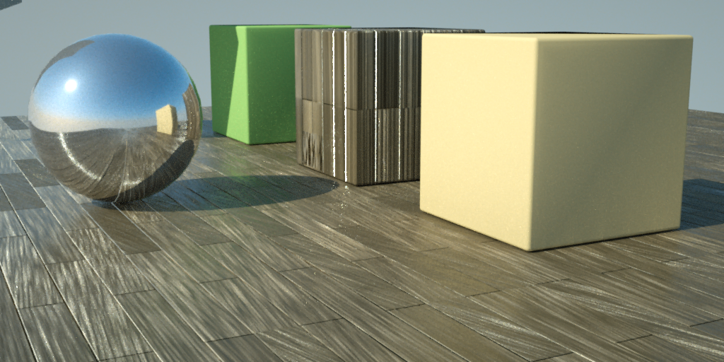

pathtracing, daylight, 100 samples, a few seconds

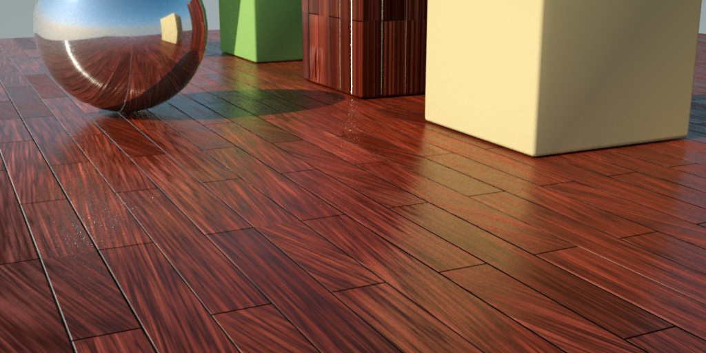

pathtracing, 1 emitter, 1000 samples a few minutes

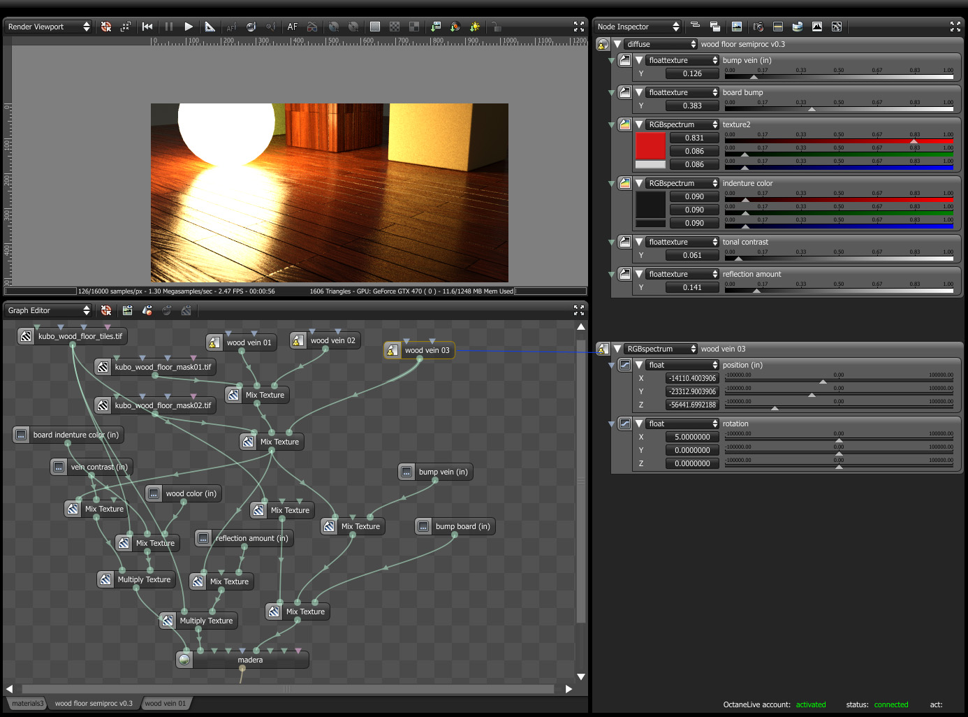

material presets and vein macro presets you can play with them to make the vein suit your needs

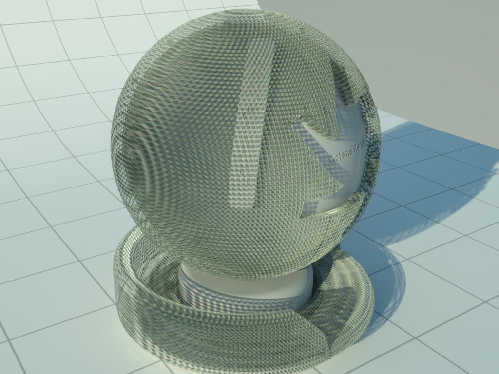

materials/non-organic/metal/Old Bronze Screen
74KB
Here's a fully procedural material for an old fashioned bronze window screen with verdigris patina
(uploaded twice by accident - first one can be deleted)
Pathtracing
Direct Lighting
