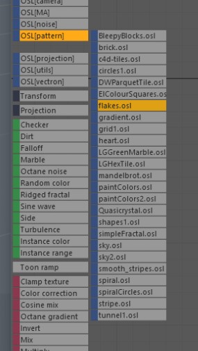

I really like that you have provided easy access to community OSL scripts in your node editor. It is really handy.
Please can you update the quick access pre-set in the Octane Node Editor to this more advanced version of OSL flakes?
