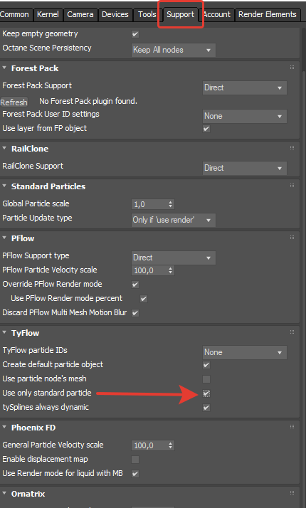

Hey tcheng00, try to mark this item, save the project and reopen it.
tyflow

Sidches wrote:Hey tcheng00, try to mark this item, save the project and reopen it.
Looks like I just needed a tymesher set to input geometry mode for it to work. Not sure if that means all my instance geometry becomes unique.
