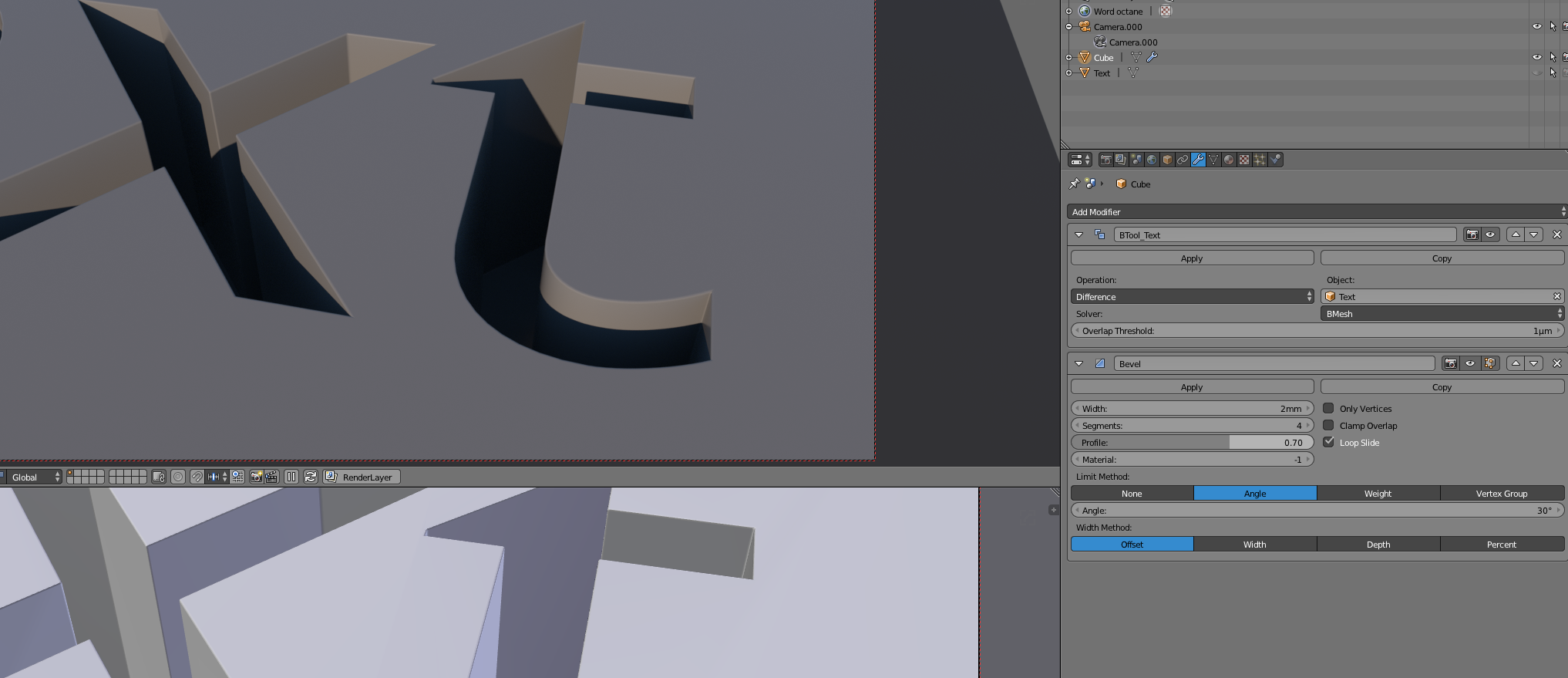

The Boolean modifier probably gives the cleanest result, especially when followed by the Edge Split modifier.
But the problem with that solution is that text edges can't be smoothed, subdivided, beveled or otherwise softened.
That's why I tried Displacement instead...
But please let me know if I'm missing something...
Before you extrude and cut a hole, with text mesh, using booleans make sure the text has enough polygons to look smooth. After this you can apply boolean and bevel modifiers.
