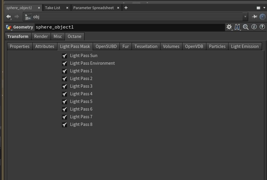

I know how to set light IDs and enable it in ROP
But I can't find the the setting that which one geometry be effected by different IDs.

juanjgon wrote:The light pass mask at the object level can be configured using the options available in the Octane OBJ spare parameters, Light Pass Mask tab.
