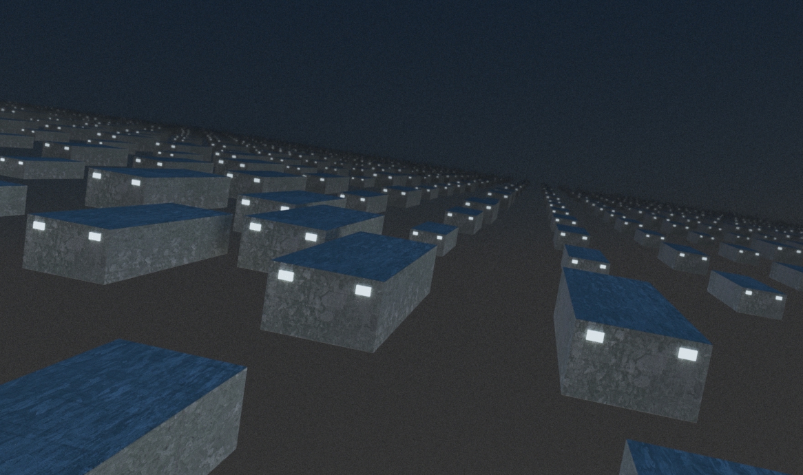

Since I really hate octane fog options (I never seem to get it right), I went looking in a fake fog direction. Well, maybe this is an option. This was created using instanced planes with all 99% (or whatever you like) transmission.
At least I can control the depth of my fog better and for you guys I hope we can improve this thing in total... cause again, octane fog just doesn't deliver
Like to hear your thoughts on this.

Thats not bad, but you'll get stepping and will undoubtedly run into some other weird issue.
Why not just render out a z-depth pass and apply fog in post?

If you replace scattering with emission, you get fake z-depth looking "fog" that renders realtime, completely noise-free even on a single gtx780 in 1080p. Great for aerial perspective, spotlights, spaceship thrusters etc. It works on specular medium as well as VDB volumes.
Then you can use smaller additional volumes with proper scattering in foreground areas that need god-rays, shadows, explosions etc.
That way adaptive sampling will be able to help cleanup the noise and you get a faster render without sacrificing realism.
Also, you don't need to make a box around your entire scene, all it takes is a small, single polygon oriented towards the camera with a specular material with index=1, transmission=1 and scattering medium. Just parent it to the camera and hide it in the 3d viewport. It will cover entire scene with fog. Cool thing is that It will NOT affect environment and that means you can blend fog with your HDRI or use the same HDRI as emission in the Scattering Medium.
