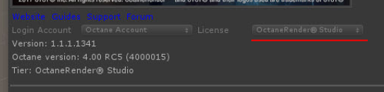

I received the same error messages as the previous poster. I followed your direction of logging into ORC via the web interface and it says my subscription is missing Image
But when I log in, ORC is inactive (which i don't remember was necessary to use the Octane Unity Plug in?) yet my OctaneRender subscriptions are available Image
When I launch Unity and Load Octane Using my OTOY account i receive this message Image
And when I swap my login account to my Unity Account I receive this error in the console Image

I followed the steps of logging into ORC via the web interface and it says my subscription is missing (which i didn't know was necessary to use the Unity Plugin):
When I log in to my account it says my subscriptions for OctaneRender are available:
When I launch Unity - and use my Otoy Account to load Octane I receive this message:
When I swap to my Unity Account I receive this error in the console:
Any ideas?

It looks like you are trying to use an Octane Studio license from within Unity, while you have an Octane Prime subscription.
- Rick

Xhed wrote:It looks like you are trying to use an Octane Studio license from within Unity, while you have an Octane Prime subscription.
Thank you good sir!
