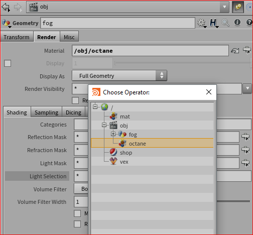

As a side note i am not able to see octane shader located in a Mat context to assign them at obj level.
It does work in shop context.
when i do the assignation of the path manually it does work, so it's more a UI problem i guess.
fantome
Posts: 266
Joined: Wed Dec 16, 2015 3:38 pm
Re: Be able to choose to work in subnet or not.
Postby juanjgon » Mon May 07, 2018 11:17 am
juanjgon Mon May 07, 2018 11:17 am
You need to enable the material flag in the node (the top-right brown flag)
Postby fantome » Mon May 07, 2018 11:25 am
fantome Mon May 07, 2018 11:25 am
Great Juanjo ! It works
thanks for your great support.
