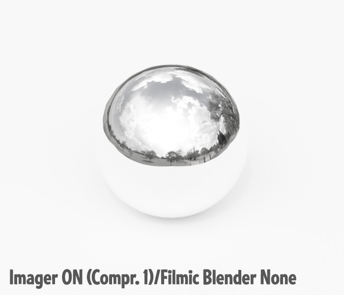

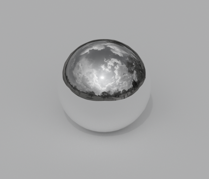

I can't really get a good linear result ouf of the Octane Imager. It's always too punchy and the highlights are gone very fast. Interestingly the sRGB response type is less contratsy than the linear one, which is completely different in Filmic Blender. The result works well will Octane Imager OFF and Filmic Blender ON. But I was told, that I should not use Filmic Blender in combination with Octane. So how can I get the result that I want with just the Octane Imager. Here are some tests. The lighting is intentionally overexposed to enhance the effect.
Here's the result I want. Octane Imager is OFF anf Filmic Blender is ON. The highlights are well preserved.

Here's the result with Octane Imager OFF and Filmic Blender OFF (Compression is 1).

I've used all these settings (as you can see in the blend file). Yet the highlights are blown out, even if I set Highlight Compression to 1. Even in the EXR the details in the highlights are gone.

As I've written before the hdri image power is too high. Set it to 1 and Highlight compression to 1. The image will not be overblown.
In Color Management set the "Display Device" to "None"

I know that my settings were too high. They were cranked up to test the highligh compression og both Filmic Blender and Octane. As you can see, Filmic Blender does not mind.
The scene with your settings is too dark. The ground is pure white and in your rendering it comes out at 70% gray.
I'll see what method I will use in the future. I can always fall back to the Filmic color management if I should need it. I might have been lucky with a LUT version of the Filmic management, but so far i was not able to find a CUBE vesion that I can load into Octane.
Cheers,
