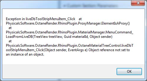

I have installed Rhino 6 with Octane 3.08.0.88 (Octane 3.07 standalone) and I am getting some intermittent errors when using the material editor.
Firstly the materials aren't displaying correctly in the material editor. The standard materials look fine but the Octane don't.
When I first open a scene I get the errors. Then some time later I don't. But the material preview still doesn't work?
The renderer seems to work fine if I open a scene and just render. But if I try and adjust a material or add a texture it gives me these errors.
I also had an error when trying to use the LiveDB.
Any ideas?
I also note that the Octane materials don't display correctly when using the Rhino shaded or rendered display. Is this the same problem?
Matt

I could not reproduce this error. Can you pls provide an exact set of steps which will produce the exceptions you are getting?

Postby face_off » Thu Apr 19, 2018 2:22 am
face_off Thu Apr 19, 2018 2:22 am
Thanks for providing those steps.
These issues appear to be a bug in Rhino6. I have contacted McNeel to help sort out a resolution.
I will report back here once I know more.
Posts: 15476
Re: Rhino 6 material editor errors
Postby face_off » Thu Apr 19, 2018 1:12 pm
face_off Thu Apr 19, 2018 1:12 pm
Pls see release 3.08.0.90 for the fixes to some of these issues at https://render.otoy.com/forum/viewtopic.php?f=41&t=55093&start=230.
