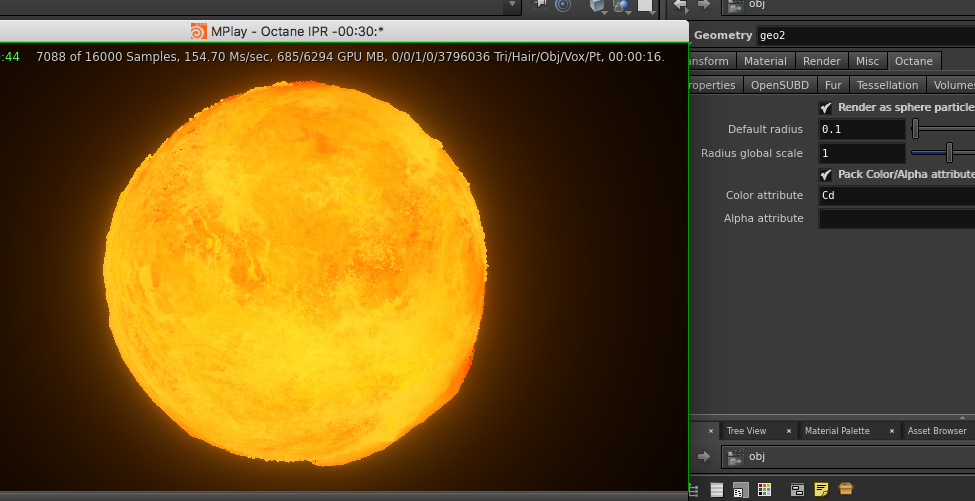

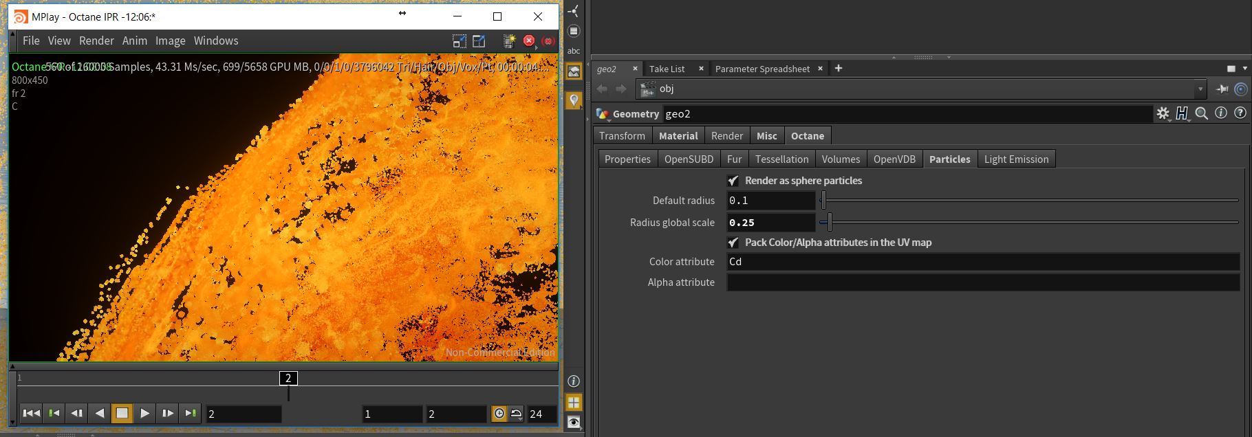

I'm experiencing very weird performance with alpha channels in live viewer. Downloaded the Houdini Octane Demo to test the look of a project. I have a sphere made of many particles, in live viewer by default I see the Octane Environment in the background, I don't want this to show so I check "alpha channel" to remove the environment, but that then changes the density of the particle sphere. When I've used Octane in C4D turning on Alpha Channel has never affected the actual image, even with particle renders. You can see in the two attached screenshots, it looks correct / how I would expect in the image with the environment showing, but I obviously need to be able to see it without the environment in the background without the density changing to be able to work properly.
Not sure if this is only an IPR bug or if it's happening when rendering, I'm still on the demo as I wanted to make sure this would work before getting the full version. If this is something demo specific tho happy to get the full version to alleviate the issue. I'm on Houdini 15.5.717 OSX with the latest version of Octane Demo.

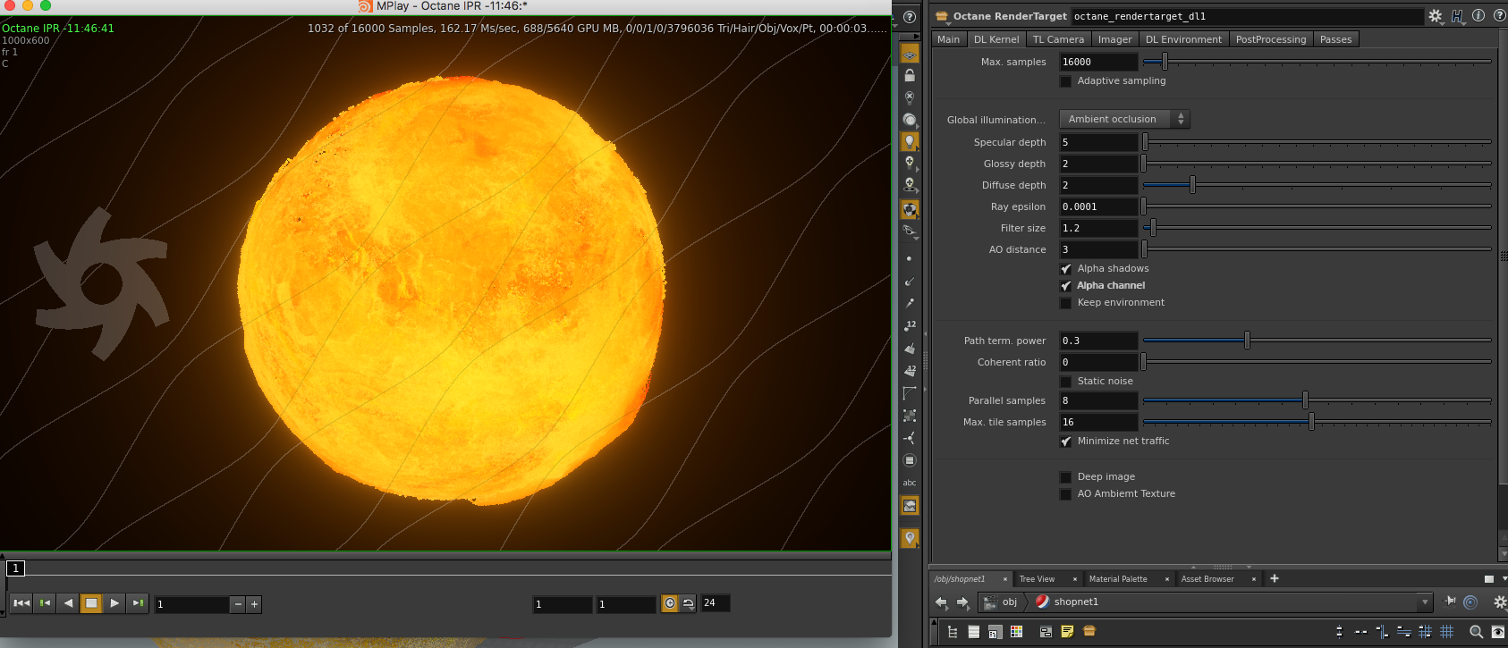

I'm trying to configure particle scale and am noticing no changes. I've changed the multipliers by large margins but the image looks identical. I am setting particle with my wrangle node at the geometry level but even when I delete that setting and try to set particle scale exclusively with the Octane OBJ parameters nothing is changing. Additionally, nothing is refreshing in Mplay when I change a Octane OBJ param. I'm having to close Mplay and reopen to try and see any change – is there no way to refresh ?
Also, whenever I open IPR on the scene for the first time, or when I go to render, the output is grey and uncolored. In IPR I can get it to work by checking off and on the 4k RGB texture reference in the shader, but currently can't get anything but grey in my render.

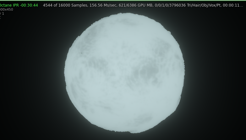

I think that the problem with the particles color is related to your workflow. You are using at the same time an emissive material and you have enabled the Light Emission options in the OBJ spare parameters. Both lighting options must not be used at the same time. The Light Emission options in the spare parameters are designed to don't need to deal with emissive materials while building custom mesh light sources.
In your scene, I think that you only need to disable the Light Emission option and work only with the emissive material to avoid any problem, as you can see in the attached image.

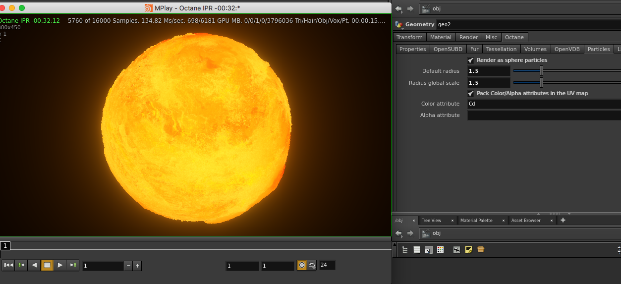

I'm investigating the particles size issue and really I can't find any problem with this feature on your scene. The particles size is extracted from the "pscale" point attribute. If this attribute is not available the Default radius in the OBJ spare parameters is used.
The Radius global scale parameter also seems to work fine, as you can see in the attached images. Can you please check this issue again on your side? Be aware that you need to reload the scene to see the changes after modifying any OBJ spare parameter.
