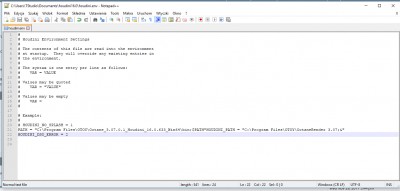

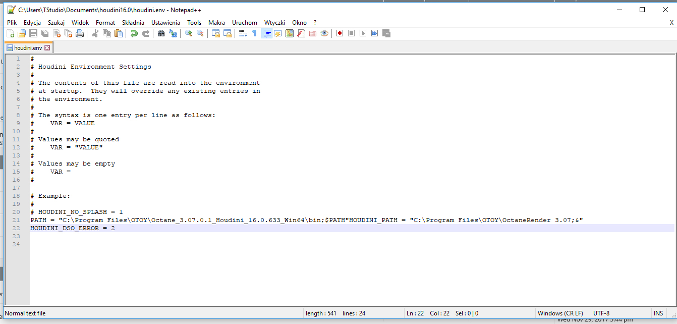

Hi guys.
I just bought Octane redner for Houdini and I can`t even install it ....
Can you help me with this... I`m on windows 10.
I have tried to modify Houdni.env file.. but once restarted Houdin doesn`t show my Octane bar..
Waht I`m doing wrong ??

The houdini.env file has a couple of mistakes (not your fault, the docs must be updated). It should be:
Code: Select all
HOUDINI_DSO_ERROR = 2
PATH = "C:/Program Files/OTOY/Octane_3.07.0.1_Houdini_16.0.705_Win64/bin;$PATH"
HOUDINI_PATH = "C:/Program Files/OTOY/Octane_3.07.0.1_Houdini_16.0.705_Win64;&"
But in any case, the main problem here is that Houdini Apprentice doesn't support external renderers, so all the Octane ROP node render functions are disabled. You could open the IPR to test the plugin, but you are not going to be able to render to disk anything.
Houdini Indie supports external renderers, but the Apprentice version not.

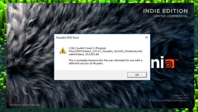

Hi Juanjo.
I have bought Houdini indie :-) version 16.5.323 and I have installed Octane for Houdnini "Octane_3.07.0.1_Houdini_16.0.633_Win64" but I get this error...
Waht version of Octane should I use?

The Houdini version and the plugin version installed and pointed by the PATH and HOUDINI_PATH variables must match. If you have the "Octane_3.07.0.1_Houdini_16.0.633_Win64" plugin installed in your HD and configured in the houdini.env file, you must download and install Houdini 16.0.633 to work with it.
Re: Instaliing Octane redner for Houdini Apprentice 16.0.705
Postby juanjgon » Mon Dec 18, 2017 11:30 am
juanjgon Mon Dec 18, 2017 11:30 am
More related information. The current Octane 3.08 test build has a proper plugin build for Houdini 16.5.268.
You are working with the latest Houdini 16.5.323 production build, but the current plugin for the 16.5.268 should work fine on it, so after installing the 16.5.268 plugin build on your HD, if you configure your houdini.env file adding these lines, it should work fine:
Code: Select all
PATH = "C:/Program Files/OTOY/Octane_3.08.0.0_Houdini_16.5.268_Win64/bin;$PATH"
HOUDINI_PATH = "C:/Program Files/OTOY/Octane_3.08.0.0_Houdini_16.5.268_Win64;&"

Postby TStudio » Mon Dec 18, 2017 4:02 pm
TStudio Mon Dec 18, 2017 4:02 pm
It worked :-) I`m soooo happy!!!
