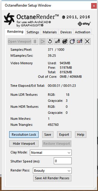

Hi Rappet. I am also noticing a difference at the video ram.
With the display card (M5000 Quadro activated) I see a 2GB difference
If I deactivate the Quadro and leave the 2x TITAN X activated I notice 3GB difference!!!
Is this normal?
I also noticed that if I change a folder name with a proxy used from that folder everytime octane is started is giving a message to search the file. Shouldn't the file be updated the first time I set the new address of the proxy?

1. The free vram is shown wrong...need to check if this i also with other scenes.
This looks right to me. Windows & ArchiCAD will use about 2GB VRAM.
These figures look right to me. Used + Free + whatever-Windows-and-ArchiCAD-is-ising = Total.

Thanks Paul for the info.
Is it possible to dedicate the TITAN Xs just for OCTANE so windows and Archicad can use only the QUADRO.
It is strange that even when I deactivate the Quadro from the OCTANE menu the TITANs are still loosing 3GB (25%)
So even when the Quadro is used for my displays and not used by OCTANE seems that something is decreasing the VRAM memory from the TITANS.
Yes, plug you monitor into the Quadro and disable the Quadro in the Octane devices tab. It you do this - try in Standalone first - so that you get VRAM usage figures which exclude whatever ArchiCAD might be using.
The screenshots you posted only shows 2GB being lost.
You are right I forgot to add the used VRAM so it exactly as you said concerning the VRAM numbers that look normal. Is it possible to dedicate, with an app or a setting, the titans only for octane while archicad and plugin are used?
