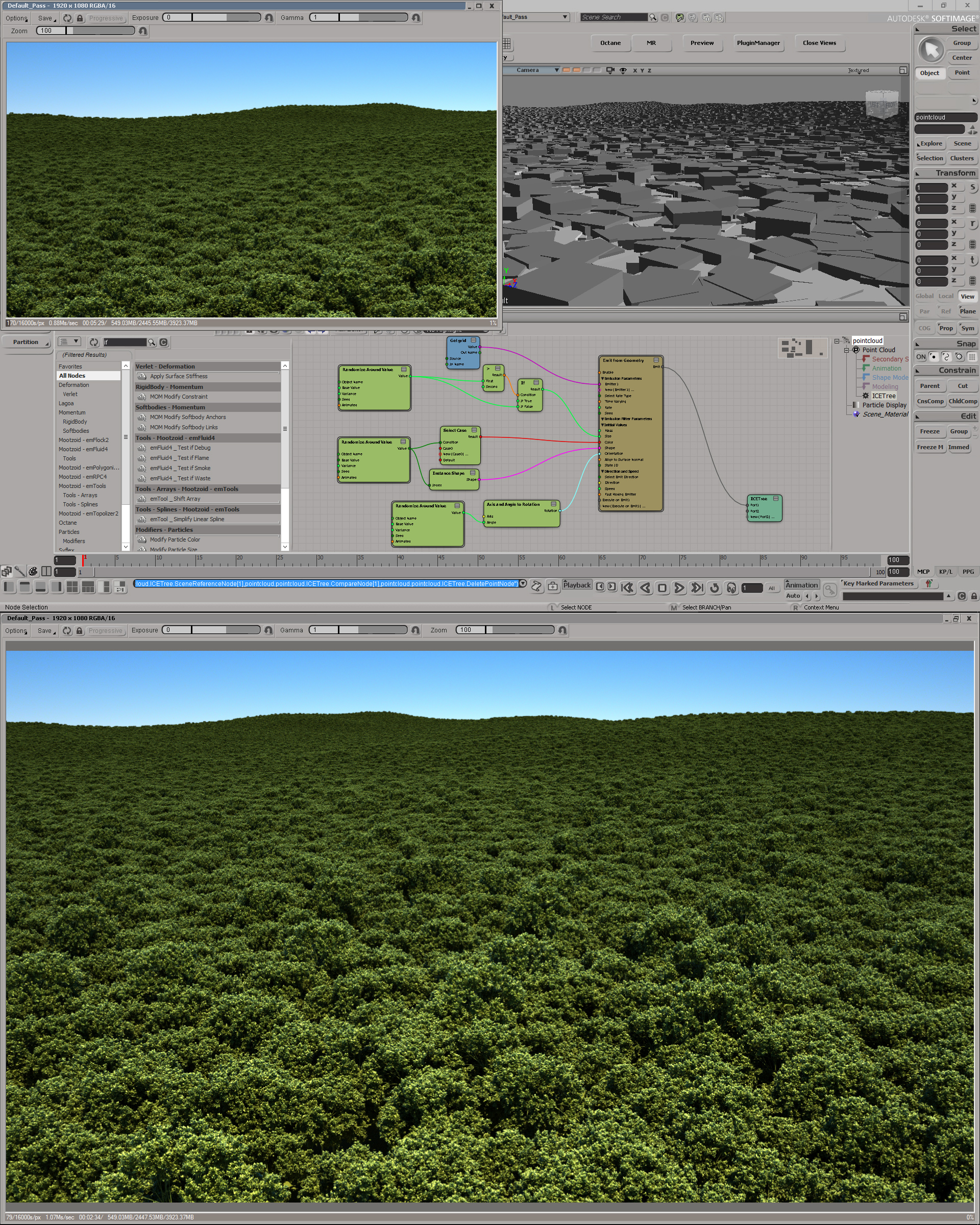

Another test with 1.5 mio trees.
http://vimeo.com/user2509578
face

Postby PeterCGS » Sun May 22, 2016 7:24 am
PeterCGS Sun May 22, 2016 7:24 am
Nice! How much time does it take to export data to the render engine for a scene like that?

Postby face » Sun May 22, 2016 7:28 am
face Sun May 22, 2016 7:28 am
PeterCGS wrote:Nice! How much time does it take to export data to the render engine for a scene like that?
If you can wait a second, i will measure it ;)
face
Posts: 3204
Re: Octane for Softimage 1.04 RC2 [Current]
Postby face » Sun May 22, 2016 7:34 am
face Sun May 22, 2016 7:34 am
Ok, from start and after check the OctaneLive id, it needs 18seconds for the first samples.
On a i7 2600K CPU, modern ones should be faster.
The export to the render engine will take 2seconds, the most time is spending with the update progress from Octane.
Must fix one bug, then i will release it.
