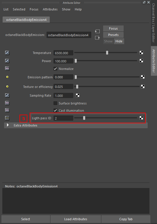

Analog to Render Layer IDs, you use Light Pass IDs:
OctaneRender Settings
Step 1: Check "Light Pass ID" in the "info passes" tab, to actually render the Light Pass IDs.
Step 2: Then select them as a preview pass to display.
Attribute Editor
Step 3: Select a light pass ID in for example the emission node of your diffuse material.
Result:

this is 8 point lights using the 8 possible light pass ID

well, just use light pass ID 73, light pass ID 18 and light pass ID 36, if you only want Red Green and Blue mask.
73 = Red
18 = Green
36 = Blue
But there must a misunderstanding here, "light pass ID" pass has a very few usage, it only creates color mask for the 8 groups of emitters respectively responsible of the 8 light passes...
(actually there is 10 light passes with ambient and sun pass , but only 8 with ID)
