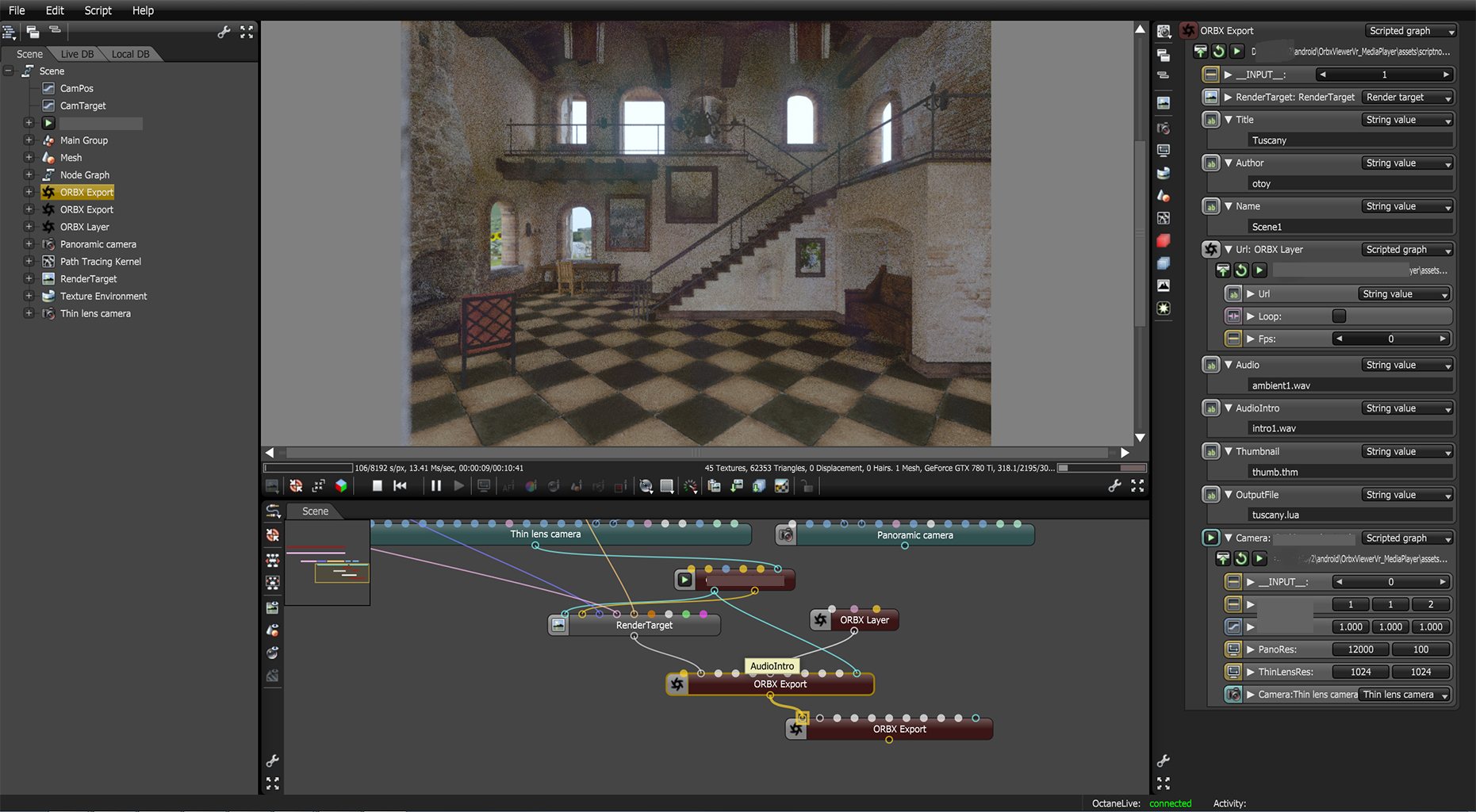

Samples are coming now that app updates correctly. We are building the authoring into Octane via script nodes, and it will export lua/JSON, publish to ORC for you. Once that is done we can finalize the documentation.
It is maybe 60% there:

To load more than a few dozen SCM frames you need to compress and package as OKX compressed textures, which we do on ORC right now for each specific platform/GPU combo we support in the player (right now GVR only). OKX for mobile takes a while to encode - up to 9 mins per frame. But if you render on ORC, this can be done between frames.
We are adding script nodes (see above post) that accept camera node inputs for a set of keyframes on a path, and ORC can generate the in between frames for you. Right now, if you send a stereo cube map ORBX to orc, and render it, you can also have it packaged and compressed to ORBX file which can be loaded in your scene or played back as a video file in the player.

Looks the same as before, just wondering if that code shows all possibilities. So far I've been using this scene-setup for several presentations combining 360 Video as well as 360 photos, sounds, videos and hotspots. I'm just wondering if there are more options.
Here's my example with 20+ scenes;
