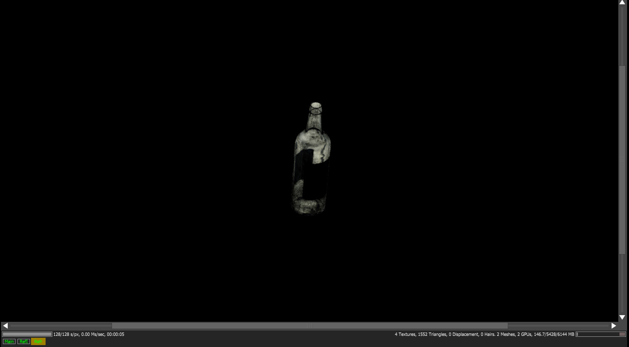

I'm trying the new animation script that is supposed to save all the render passes, however it doesn't work... :(
these are the passes as I see them in Octane:
Full frame
Reflections
Refractions
And this is what the script is saving out... :?
The files called "refractions" are actually the full frame ones, and then I have those weird files with letters, numbers and symbols... :?

Another problem, if I save the files checking the "Use multi-layer EXR" option, the saved files are empty, just black... :(
EDIT: this seems to be a bigger problem, even if I save a single EXR file, once opened in Photoshop, it comes out all black, with no layers...

Rikk The Gaijin wrote:Another problem, if I save the files checking the "Use multi-layer EXR" option, the saved files are empty, just black... :(
Yep, that looks broken. Sorry about that. I will fix this asap.
