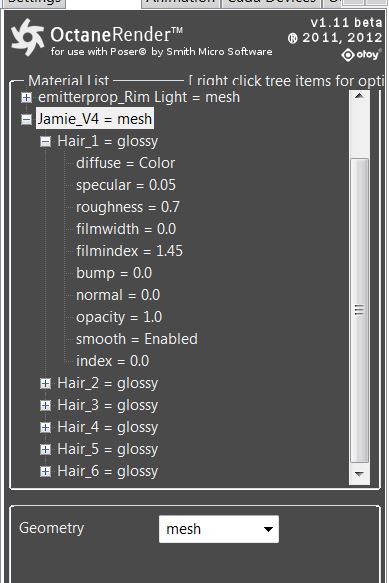

The hair is called "Jamie_V4 Hair". Here are the shots....I hope they help.

Pete, can you try right clicking Hair_1, Hair_2, etc and select "Reconvert from Poser" for each? Its possible the scene has just been saved with the blank material conversion.
Also, if oyu load the hair prop into a blank, new Poser scene and render in Octane, does it work correctly?

It looks like the image maps for diffuse and opacity didn't find their way into the Octane scene.
Can you try put them in by hand?
(changing the diffuse node to "image", put in the missing diffuse map of the hair part and changing the opacity node to "floatimage" and put in the trans.map of the hair part)

Success, at last. I don't know what happened exactly. Somehow the image maps in my V4 hair folder became unlinked to my materials....even in Poser renders. I decided to "pull the plug" (Poser/Octane) and reinstall it. It is working fine, now. Must have been a corrupted file or some such. I'll send the render, later.
