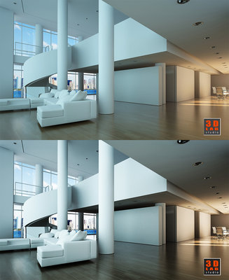

The bleach bypass in a interior (most proper to show :P)
