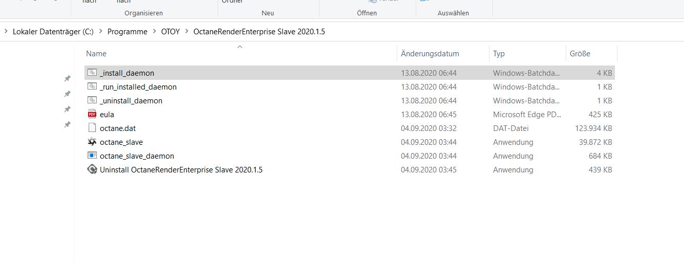

Iam trying to setup render daemon for Network Rendering and get the following error:
"ERROR: Could not find the startup directory"
What could i try to get it work?

Tugpsx wrote:While setting up a Carrara render node, it was relatively easy to get the Daemon working. During the install process be sure to "run as Admin" that will provide the correct application access. then also ensure that the network options are applied. You can also go to your firewall setting and adjust the applications that have LAN/WAN access.
Based on the language difference shown you may have to edit the batch file to properly locate and launch the application.
You can test by launching the executable from a command prompt to determine if its able to launch at all.
set BATCH_FILE=%APPDATA%\Microsoft\Windows\Start Menu\Programs\Startup\run_octane_slave_daemon.bat
if not exist "!BATCH_FILE!" (
set BATCH_FILE=!USERPROFILE!\Start Menu\Programs\Startup\run_octane_slave_daemon.bat
echo Daemon startup script does not exist. Please install the daemon first.
