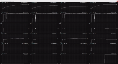

I'm running 4 980TI's in a single air-cooled box, Two of my GPU will hit there temp limit and throttle but these things are built so well I really wouldn't think too much about it. As long as you have good airflow your cards should take care of themselves. I tried putting two of these cards on risers and it was more of a headache then helpful so we just went back to what we had before. I even CNC plexi to funnel all the air into the GPU's and at the end of the day, I put it all back to normal, bought some extra high-speed front fans and let the case do the rest. I took out all the fancy things that I thought might help.
But this is just my opinion.
The one thing I can recommend about cooling is I set my fans to low or full, no ramp up. As soon at those cards get 5ยบ hotter, I have the fans go to 100%. I want as much airflow though as long as possible.
