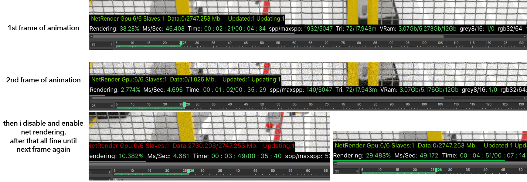

when i am rendering an animation sequence in cinema 4d, the first frame renders at normal speed with NetRender support, but the second and all other frames don't. I really can't figure it out. There are no error messages or anything, just slow renderspeed.
Once i deactivate network rendering in c4d, wait a few seconds until deamon logs out, then activate net rendering back in c4d, the renderer gets back to normal highspeed....

screenshot

After try and try i found out that when i reduce the polygons from 17.943m to 10.0000m by deleting objects it will work. Any idea why?
Unfortunately i need all objects :-(
