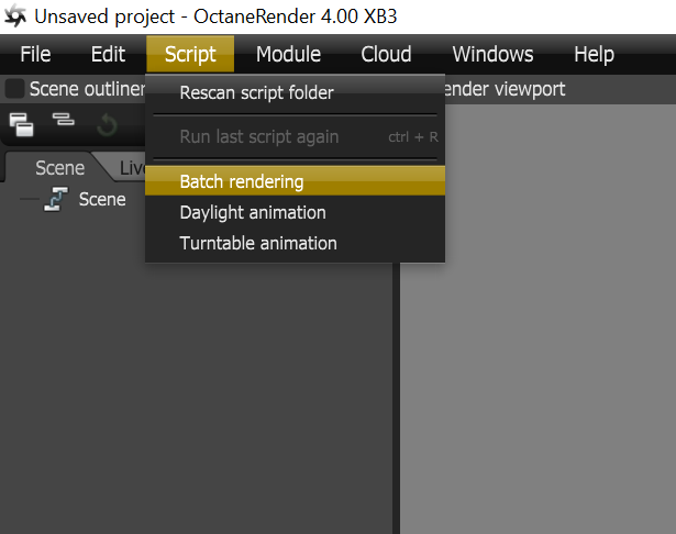

If you exported your animation in STandAlone using the ORBX format, just select the Batch Rendering option in the Script menu.
