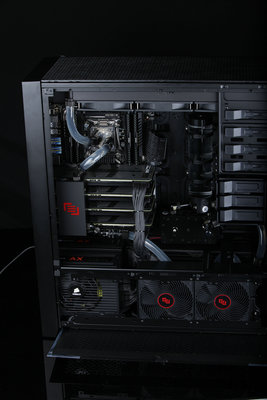

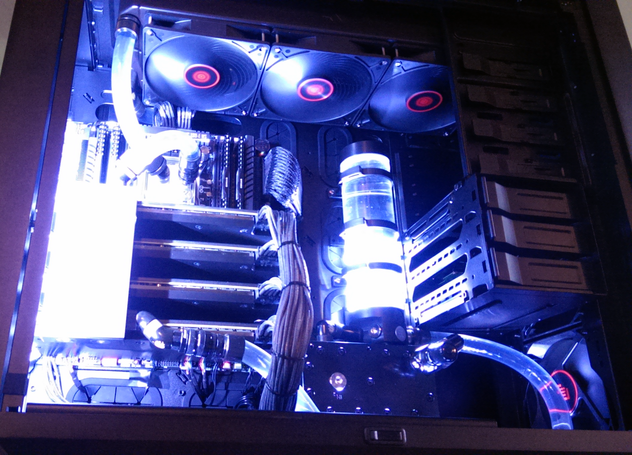

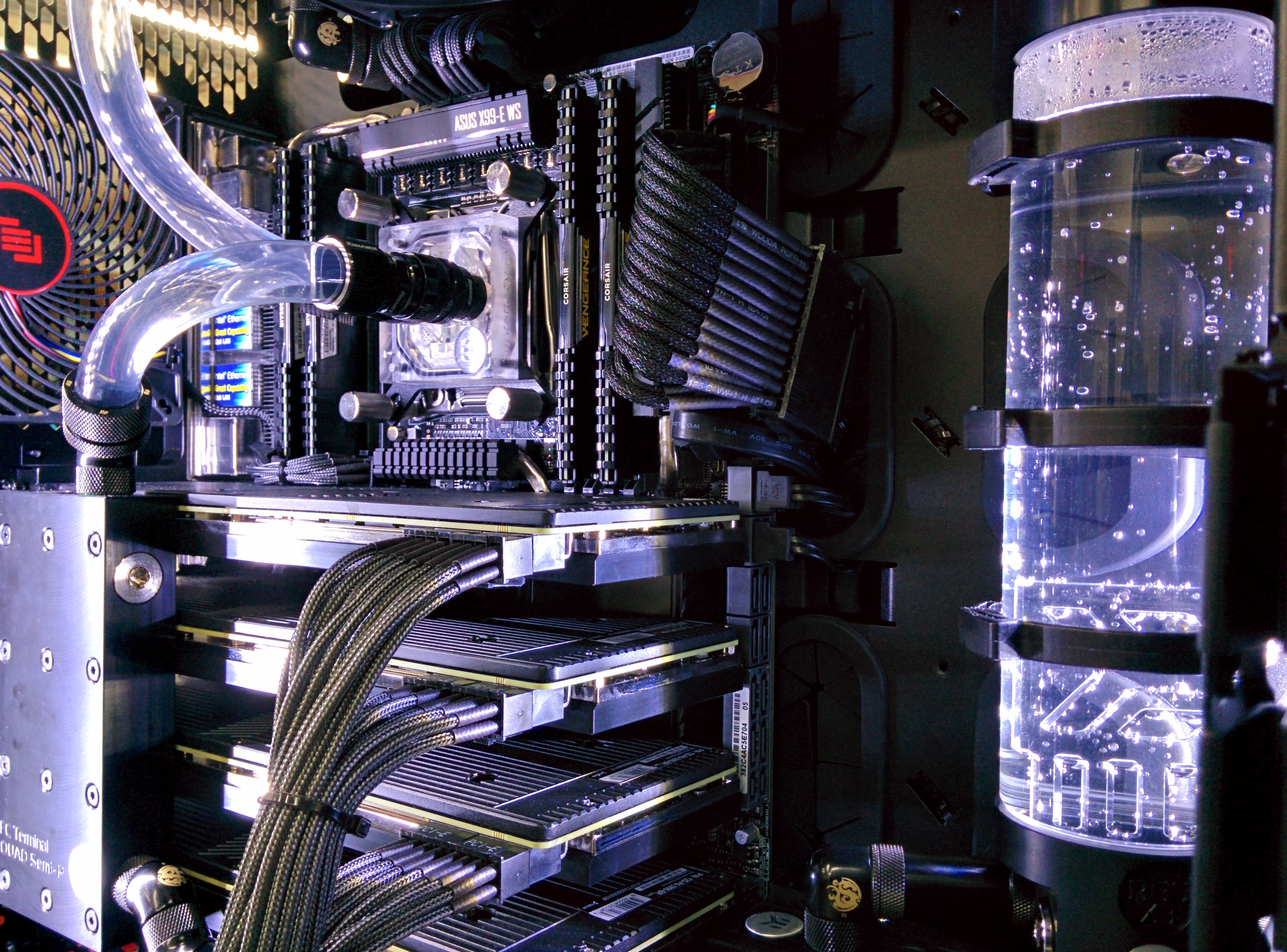

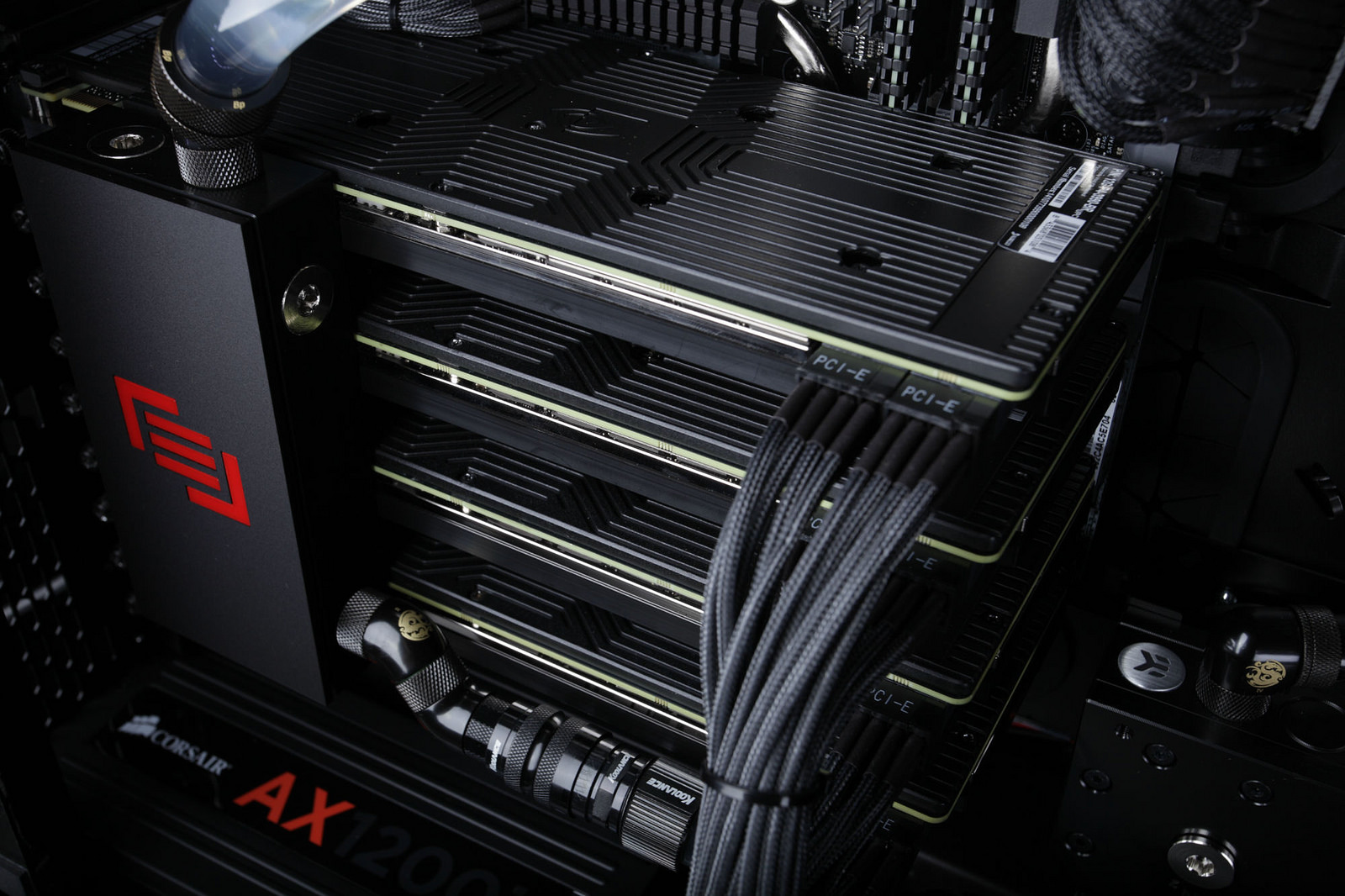

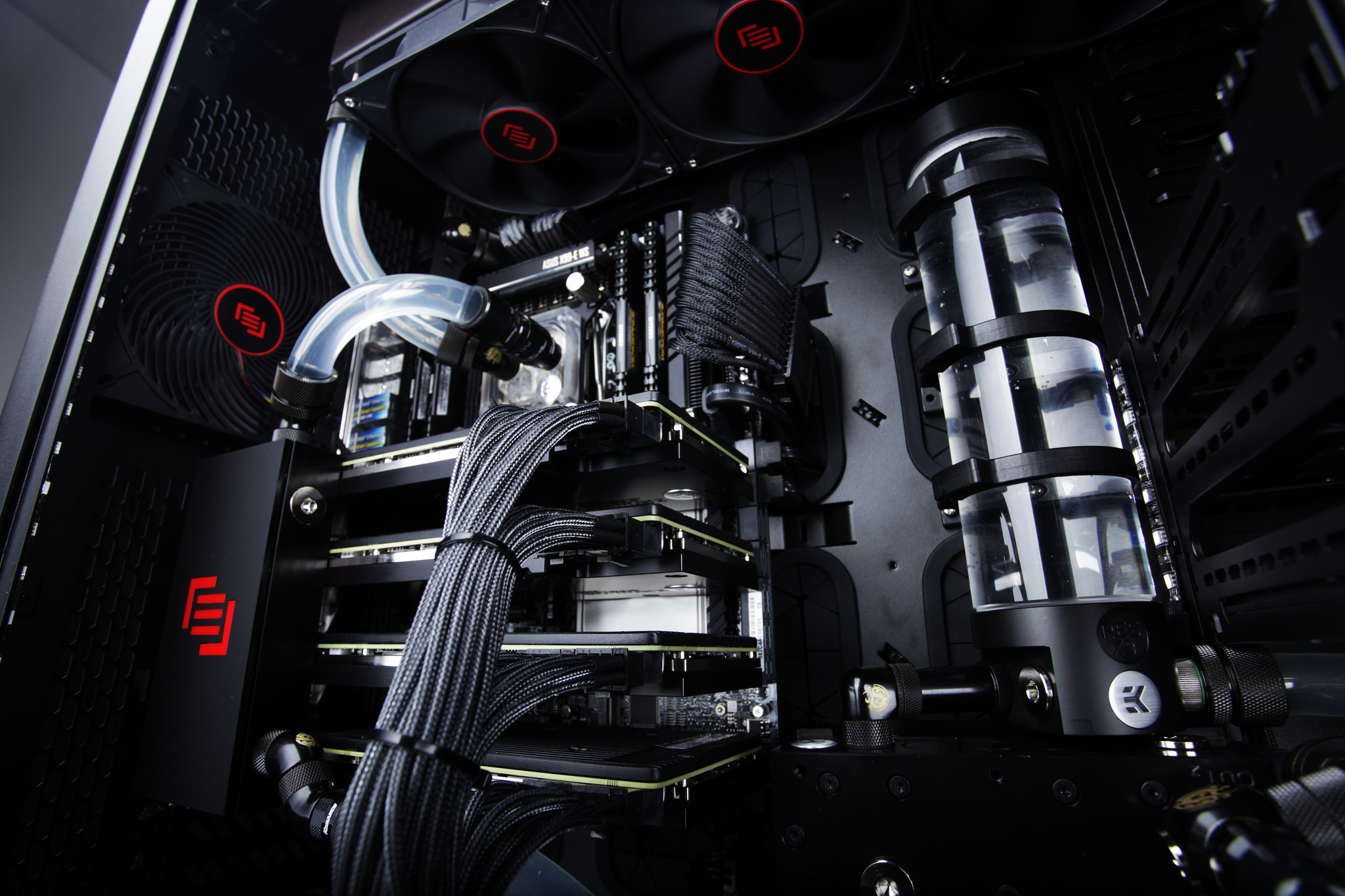

Octane Community,
The company I work for http://www.light-borne.com/ does work for some very high profile musical acts. We animate and designing their tour visuals mainly. We have a phase of the job where we travel to the rehearsal location and make changes to our work and very often make new content within a very small time frame. We are always looking for more speed because we simply don't have time to waste. Also our art director has fallen in love with the beautiful renders Octane is able to produce and change on the fly ;) These are the reasons we needed a single computer with as much render firepower as is possible that has the flexibility to travel as well.
So I commissioned https://www.maingear.com/ to build this monster! They happily took on the challenge and did a great job!
The system:
Asus X-99E WS
4x TitanZ
i7 5930K Six-Core 3.5GHz
16GB Corsair Vengeance T DDR4
Samsung 850 PRO 256GB
Dual Corsair AX 1200i
The Cooling system is all EK parts
420mm Rad on top
2 x 240mm Rads on bottom
BiTurboDual Laing D5 Vario Pumps
BENCHMARKS
Using Octane 2.14 Standalone, No OC
PathTerm @ 0.3
Coherent Ratio= Cr
Direct Light
Cr: 0.0-----------319 Ms/s
Cr: 0.5-----------348 Ms/s
Cr: 1.0-----------365 Ms/s
Pathtracing
Cr 0.0---------60 Ms/s
Cr 0.5---------69.75 Ms/s
Cr 1.0---------76.5 Ms/s
Temperatures
Idle 38˚
The range across GPU cores after 20 minutes of pathtracing was from 63-77˚
And the total for this system including 3 year warranty on parts and craftsmanship was $12,700
Thanks for looking :)

A bit worried about seemingly high temps on the loop (as it's nor very good for pump),
but I guess it's nothing bad - considering who put the pieces together.
Anyway for 12,7k$ & 3Years warranty for such custom build rid from respectable boutique
is not much at all. You'd have 0 warranty if doing everything Yourself =)

Sick scores! Great looking build, great performer. Love the sleeving, overall aesthetics.
My only concern here are temps, not gpu, but water temps. As Glimpse said, Maingear Guys know what they're doing and looking at their website - they are true passionate. Overall radiator capacity for 8 gpus + cpu is only 8 units here - I have more for 4 gpus. As you look at D5 pump specs they operate to 60C, so getting close to this limit may cause problems. Anyway 4xTitans Z are on my list :)
Enjoy rendering on this great machine!
