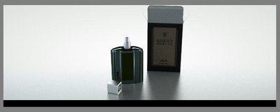

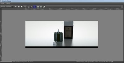

In an effort to validate the power of portability, I decided to test Octane on a Dell D630 with Windows Vista 4Gb RAM and Quadro NVS135M video card with 128Mb assigned.

I'm happy it works :)
You're gpu is very small/slow though, i would'nt expect to run anything more complex than your testscene on it...
thanks for reporting though, always interesting to see a new GPU being reported as working :)

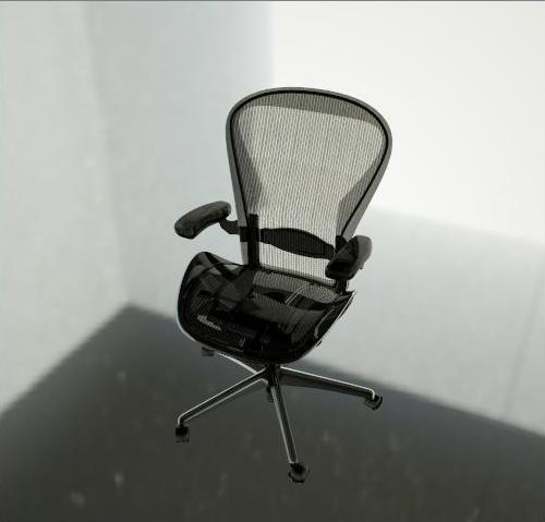

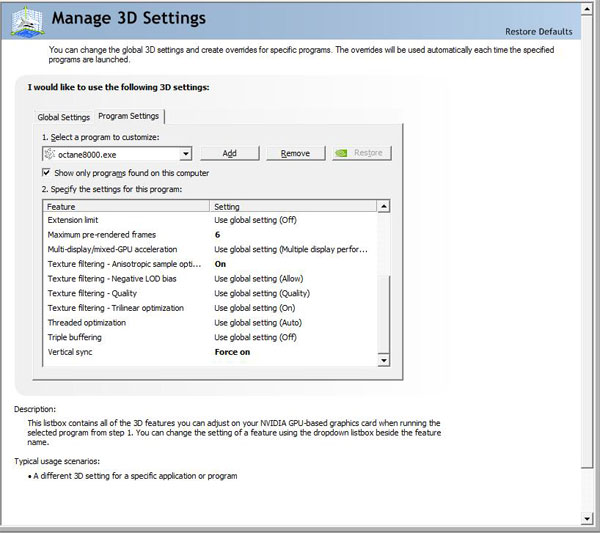

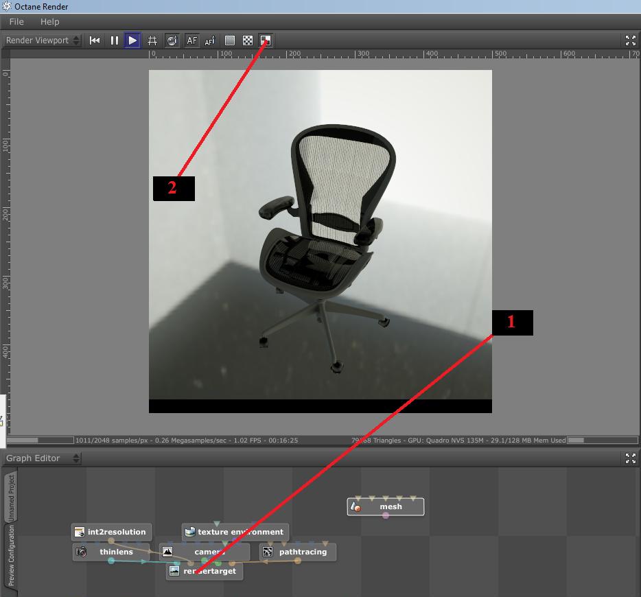

Here are a few more tests. Theses are rendered on a Laptop
Included are the settings i used and now the program appears to be more stable.
In Manage 3D settings, Under program settings tab, choose add and select the exe to modify
BTW found that setting the Texture -filtering Quality to Performance worked a lot better. More stable and was even able to open IE and Paint for screen cap and browsing while it was rendering. (may not have been wise, but needed to test it. That's why we have Alpha/Beta)
1) Setup the render environment before loading the model
2) Set to this option will allow you to move around quicker when combined with the ALT key

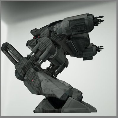

LOL, so true. You guys may want to target the SketchUp community as well, the models transfer and render very well even on a Laptop.
Will try a more complex SketchUp convert and post results.
Robocop ED model transfered from SketchUp 7 rendered on Dell D630 Laptop with Octane Alpha

Postby radiance » Sat Feb 06, 2010 4:26 pm
radiance Sat Feb 06, 2010 4:26 pm
The circular shading artifacts are because you're model is very large.
you need to use the unit conversion in the OBJ import preferences panel (file menu),
to configure you're units.
this model is probably kilometers large...
