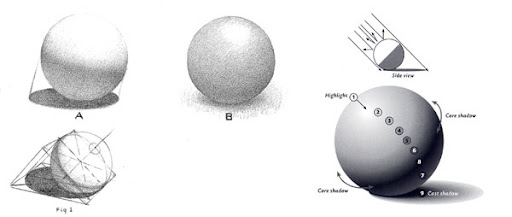

Fundamentally, in most situations it will be difficult if not near impossible to retain a "flat color swatch sample" like this due to two predominant elements: lighting and shading, which will result in "zones on an object" and image formation:
Figure 2.1. Glossy sphere (billiard ball) under a single direct light source, showing effects of specular and diffuse reflection. Photograph by David Briggs.
Figure 2.3. Diagrams of light zones on a sphere from two popular art instruction texts. Left from Loomis (1951), and right from Aristides (2007). Both works show the highlight (incorrectly) at the centre of the full light, facing the light source. As seems conventional in this sort of diagram, the diffuse reflection of light from the tabletop is shown but not the specular reflection, and a continuous band of core shadow is shown alongside the terminator. The actual appearance of a sphere in this lighting may be quite different (e.g. Figure 2.1).

In the end, the input "color values" will be inevitably affected by lighting and the resulting shading rendition.
